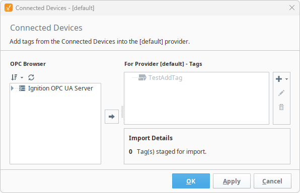

  1. In your Tag Browser, click on the Add Tag Browser Add Icon icon, then click on Browse Devices... Browse Devices Icon. The Connected Devices popup window will open.
    Tag-Based Addressing Step 1

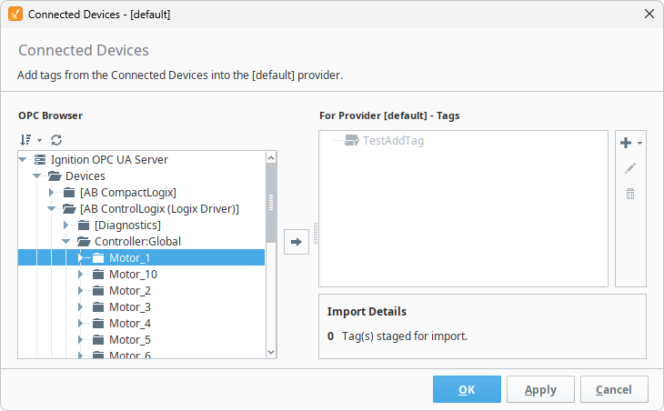

  2. Navigate to the tag you want to import. In this example, since we want Motor_1 within our connected device, we'll go through Ignition OPC UA Server > Devices > [AB ControlLogix (Logix Driver)] > Controller:Global > Motor_1.
    Tag-Based Addressing Step 2

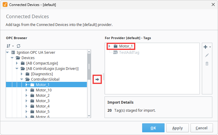

  3. Select the tag or folder to import and add it to your Tag Provider by clicking on the Add Connected Devices Window Add Icon icon. This will stage the tag for when you are ready to import, in case you want to add any other tags or folders.
    Tag-Based Addressing Example Step 3

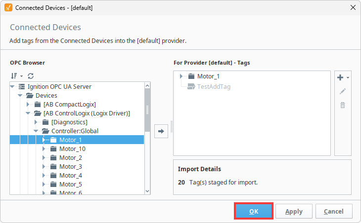

  4. Once you have added the tags and folders you want, click OK to add them to your Tag Browser.
    Tag-Based Addressing Example Step 4
Your tags and folders are now available to use in Ignition.

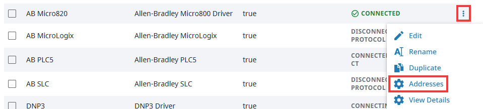

  1. Navigate to Gateway Webpage > Connections > Devices > Connections.
  2. Click the three dots menu of the Micro800 device you want to add a data point for, then click Addresses.
    Configuring Data Points Example Step 2

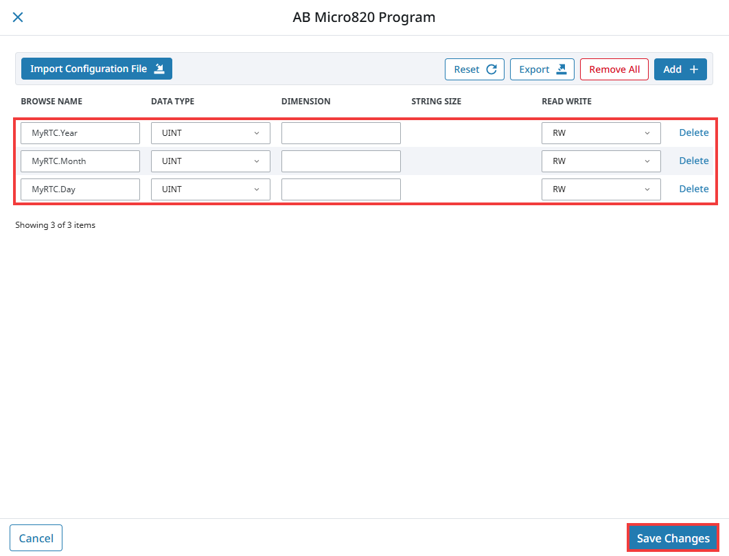

  3. The Program panel for your Micro800 device will open. Click on the Add + button on the top right of the panel. This will add a new entry to the table where you can specify a data point.
    Configuring Data Points Example Step 3
  4. Enter the information for the data point you want to expose, then click Save Changes on the bottom right.
    Configuring Data Points Example Step 4
