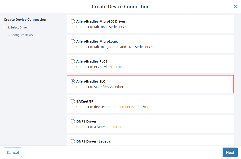

  1. On the Gateway, go to Connections > Devices > Connections.
  2. Click Create Device Connection +.
  3. Select Allen-Bradley SLC and click Next.

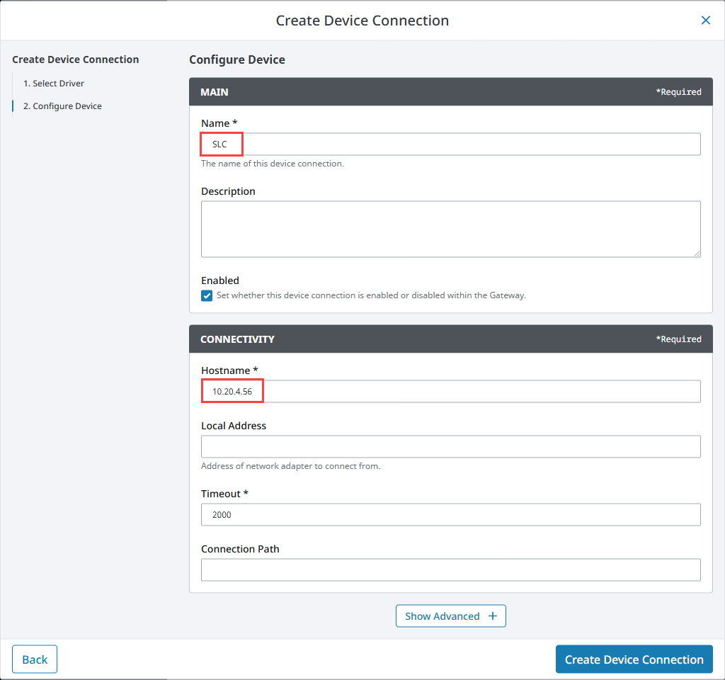

  4. On the Configure Device screen, enter the required fields:
    • Name: SLC
    • Hostname: IP address of the device (e.g., 10.20.4.56)
  5. Click Create Device Connection.

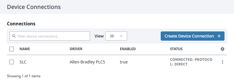

The device will be listed now on the Connections page. The status will initially show Disconnected, but will move to a Connected state.
Device Connection Settings​
Main Settings​
NameDescription
NameA user-defined name for the device. This name appears in OPC item paths and the Devices list. Name must begin with an underscore or a letter, and cannot include special characters.
DescriptionOptional description to help identify the device.
EnabledWhen selected, the device is active and available for use.
Connectivity Settings​
NameDescription
HostnameThe Hostname value is the IP Address of the SLC processor. The protocol that the SLC processor supports is automatically detected. It will use either CSP protocol on port 2222 (0x8AE) or EthernetIP protocol on port 44818 (0xAF12).
Local AddressThe local address to connect from when establishing a TCP connection. If left blank, then the driver will select an available address.
TimeoutThe maximum amount of time to wait, in milliseconds, for responses from the processor.
Connection PathThe Connection Path value is used to define the route of the PLC-5 processor to connect to. [Optional] See Connection Path Format for more details.
Advanced Settings​
NameDescription
Disable Processor BrowseDisables processor browse setting.
Zero TNS ConnectionDisables the Zero TNS connection setting.
Browse Cache TimeoutThe amount of time, in milliseconds, to cache tag structure results read from the device.
