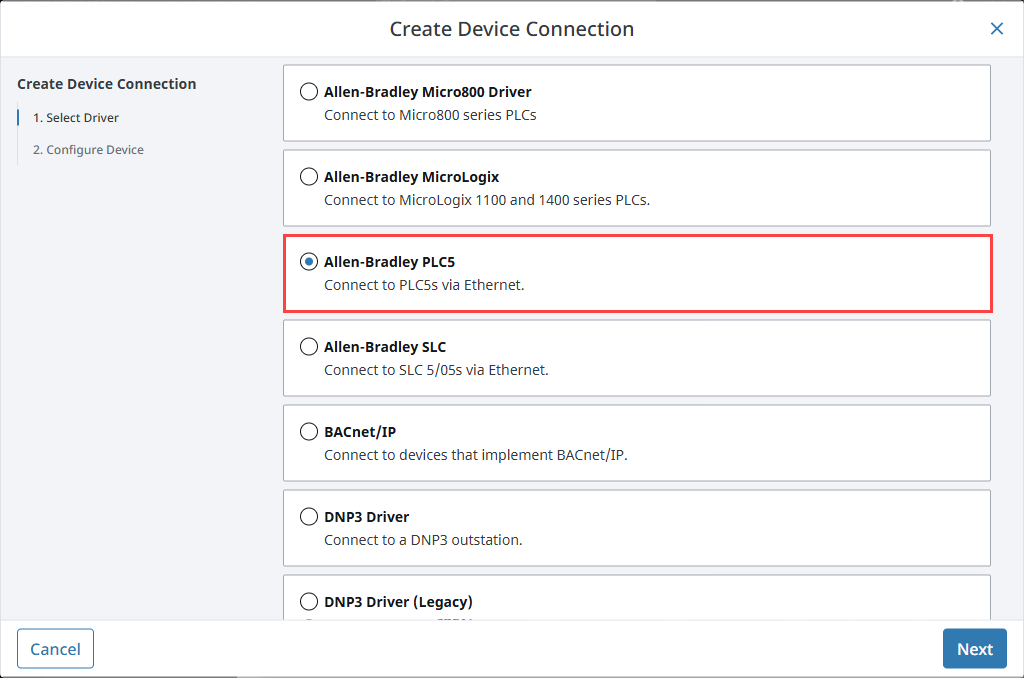

  1. On the Gateway, go to Connections > Devices > Connections.
  2. Click Create Device Connection +.
  3. Select Allen-Bradley PLC5 and click Next.

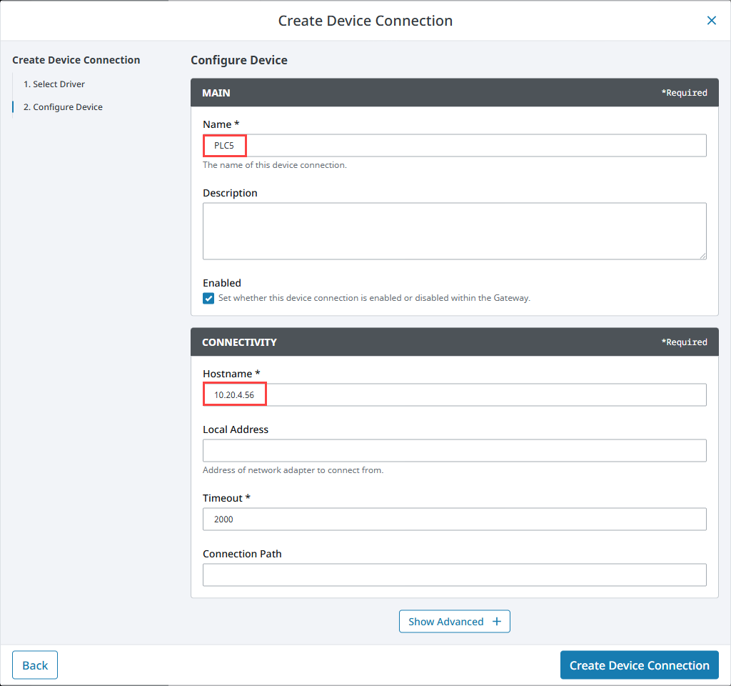

  4. On the Configure Device screen, enter the required fields:
    • Name: PLC5
    • Hostname: The IP address of the PLC5 (e.g., 10.20.4.56)
  5. Click Create Device Connection.

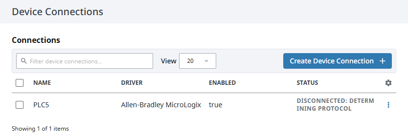

The device will be listed now on the Connections page. The status will initially show Disconnected, but will move to a Connected state.
