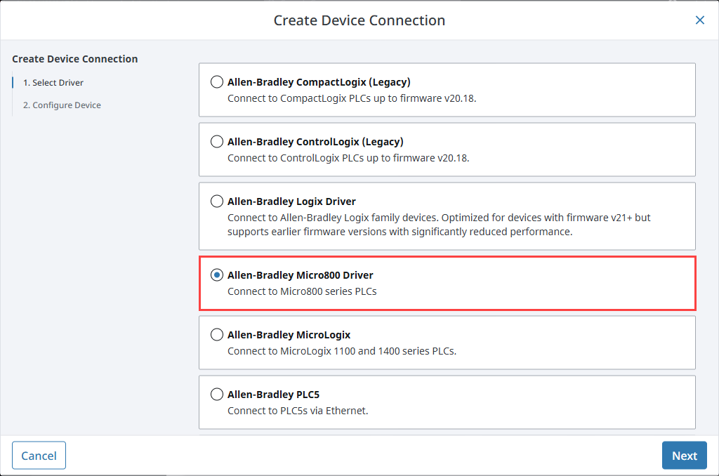

  1. On the Gateway, go to Connections > Devices > Connections.
  2. Click Create Device Connection +.
  3. Select Allen-Bradley Micro800 Driver and click Next.

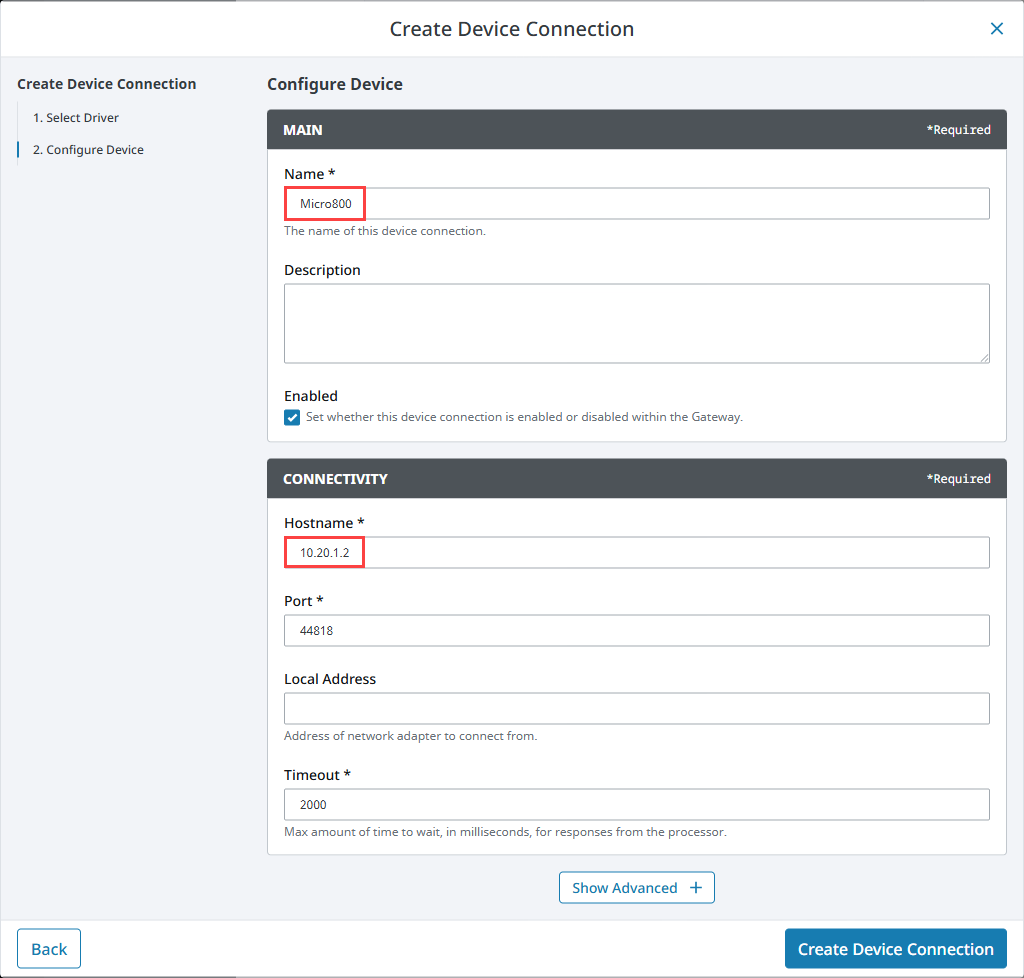

  4. On the Configure Device screen, enter the required fields:
    • Name: Micro800
    • Hostname: The IP address of the PLC (e.g., 10.20.1.2)
  5. Click Create Device Connection.

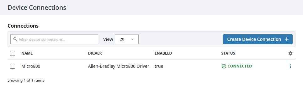

The device will be listed now on the Connections page. The status will initially show Disconnected, but will move to a Connected state.
