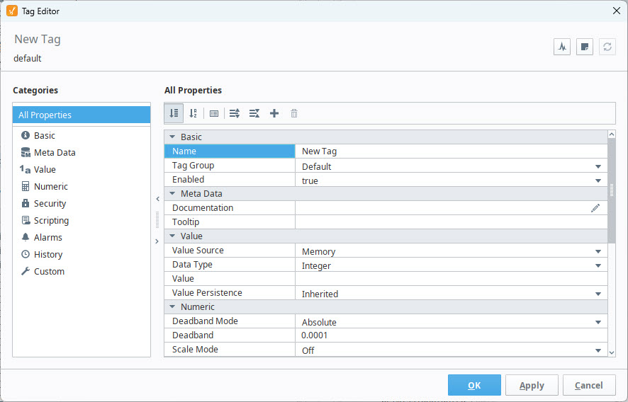

Tags can be created manually in the Tag Browser. You can create any of the Standard Tag Types or a Data Type Instance. This example creates a Memory tag.
  1. You can create tags in two different ways: click on the Add icon to open the context menu and select New Standard Tag and choose the tag type, or right click any where in the Tag Browser and select New Tag and choose the tag type.
  2. The Tag Editor will open to edit the tag's properties.

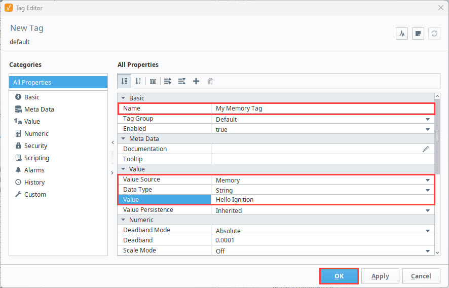

  3. Set the properties as follows:
    • Name: My Memory Tag
    • Value Source: Memory
    • Data Type: String
    • Value: Hello Ignition
  4. When finished, click OK. Your new tag will be placed in the tag column of the Tag Browser. Since this is a Memory tag, its value will not change unless you write to it.

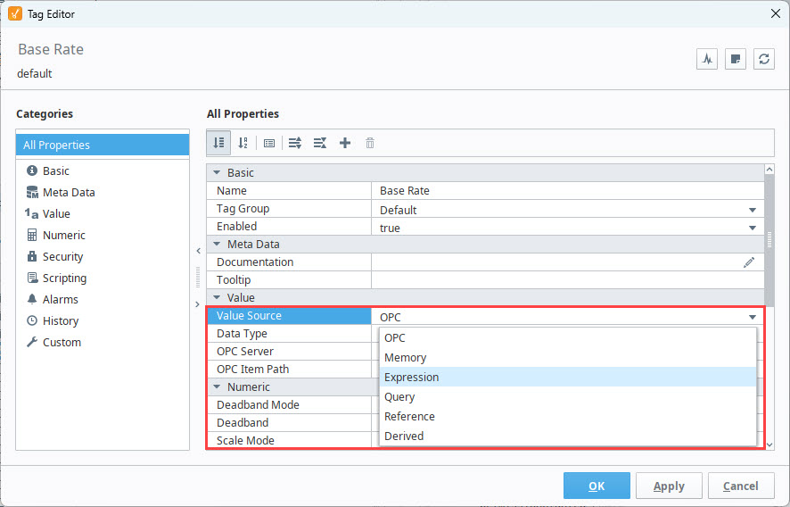

  1. To edit an existing Tag, right-click on the Tag, and select the Edit Tag icon.
  2. Once in the Tag Editor, you can update the Tag properties. For example, if you want to change the Tag to a different type – such as from OPC to Expression – go to the Value Source property, click the Expand icon, and choose the type of Tag (OPC, Memory, Expression, Query, Reference, or Derived) that you want.
