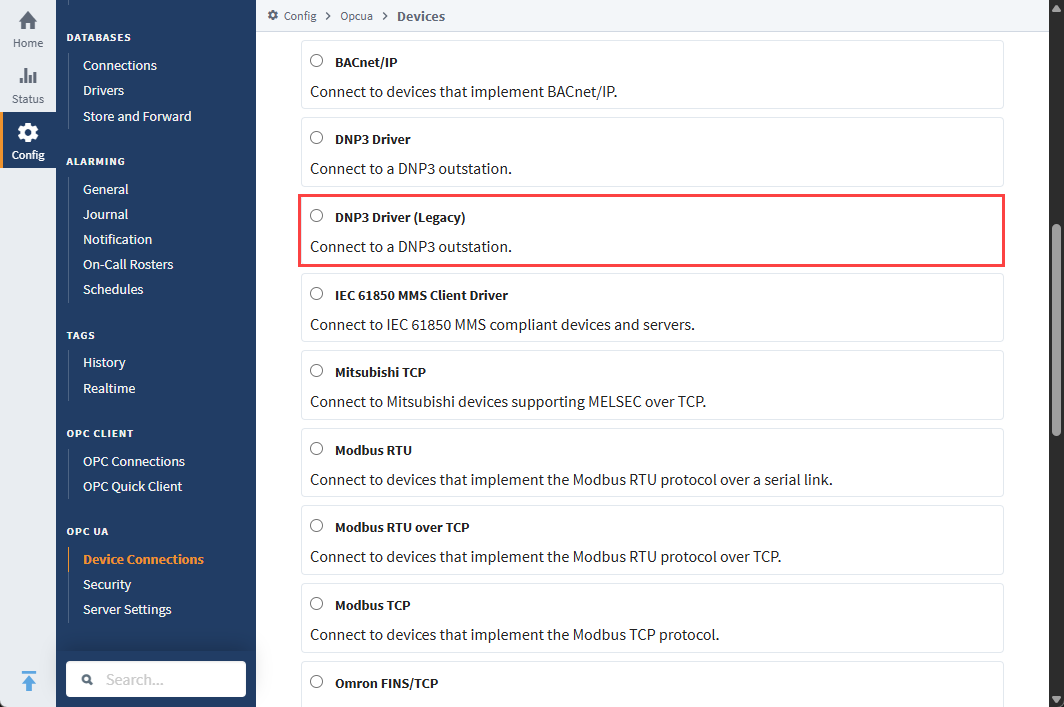

The Legacy DNP3 driver connects to devices that support Ethernet communication through a master station. Create a separate device connection for each outstation (remote device) by setting the source and destination addresses in the device connection settings.
  1. Go to the Config section of the Gateway Webpage.
  2. Select OPC UA > Device Connections.
  3. Click Create new Device.
  4. Choose Legacy DNP3 Driver, then click Next.
  5. On the New Device page, enter:
    • Name: Legacy DNP3
    • Hostname: IP address or hostname of the device
  6. (Optional) Click Show advanced properties to configure additional settings.
  7. Click Create New Device. The Status will change from Disconnected to Connected or Idle.
