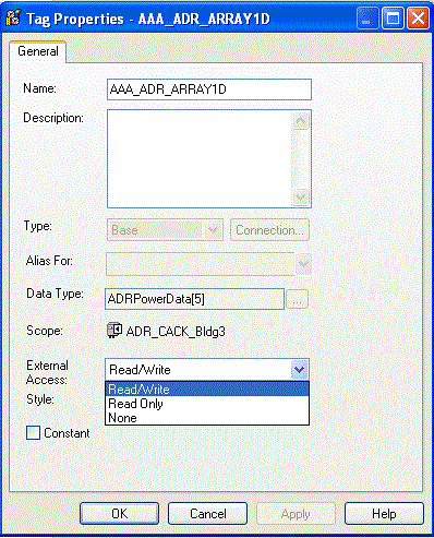

Considerations for ControlLogix Settings​
When the ControlLogix processor External Access setting for a tag is set to None, the tag information is not returned to Ignition during reading of tag information.
Using RSLogix 5000, change the External Access setting to either Read Only or Read/Write for the tag to show in the Ignition browse results.
