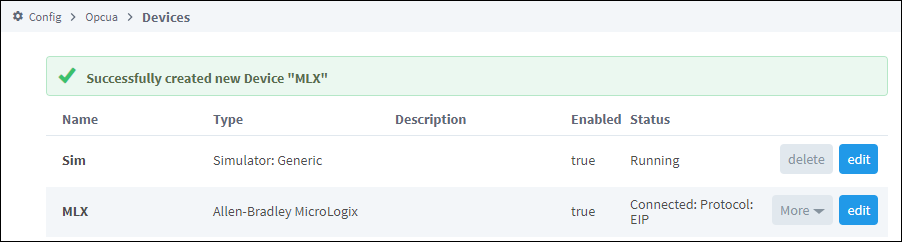

  6. Click Create New Device.
  7. The Devices page is displayed showing the MicroLogix device is added to Ignition. The Status will show as Disconnected and then Connected.
    Connect to MicroLogix Device Step 7
