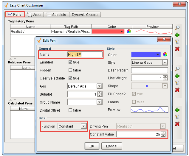

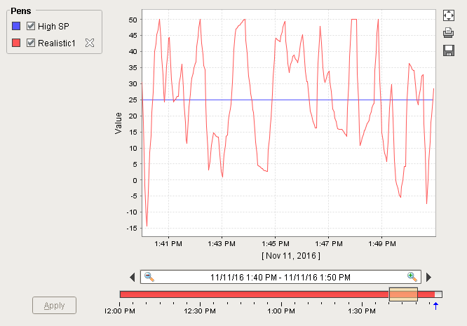

    Add a calculated pen name called 'High SP.' In the Function field, select 'Constant' from the dropdown list, and set the 'Constant Value' at '25.' Click OK.
    note
    Calculated pens are just like other pens, so you can specify the style, color, axis and subplot in the Edit Pen window.
  3. Press OK again to view your High SP pen on your Easy Chart. The High SP value of 25 is represented on your Easy Chart by a blue horizontal line.

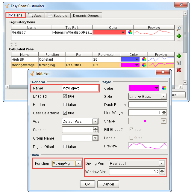

    On the Edit Pen window, enter the calculated pen name called 'Moving Average.' In the Function field, select 'MovingAvg' from the dropdown list. Set the Driving Pen to 'Realistic1,' also from the dropdown list. (If you have more Tags that you dragged on to your Easy Chart from the Tag Browser, you'll have more pens to choose from in the Driving Pen dropdown list).
    Specify the Window Size which is the percentage of the total time period that you are going to do a Moving Average on, for example 20%. Press OK.

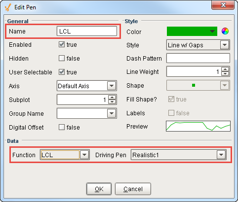

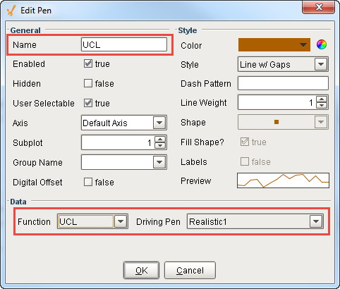

  5. Let's add two more calculated pens: one for Upper Control Limit (UCL) and another for Lower Control Limit (LCL), and set the Driving Property to 'Realistic1.'

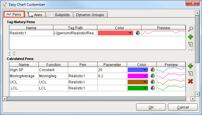

  6. Once you added all your calculated pens, you'll see all your pens in the Calculated Pens Table at bottom of the window. Press OK.

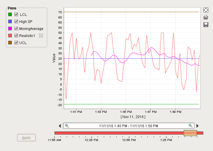

  7. Now, all your calculations are displayed on your Easy Chart. The blue pen is the Constant, the pink pen is the Moving Average, and UCL and LCL are brown and green respectively.
