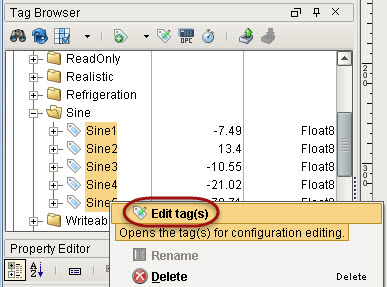

  1. Go to the Designer, from Tag Browser, select one or more tags. For example, select all the Sine tags in the Sine folder.
  2. Right-click on the selected tags, and then select Edit tag(s). The Tag Editor window is displayed. Here, you can edit the tag and change the name, data type, scaling options, metadata, permissions, history, and alarming.

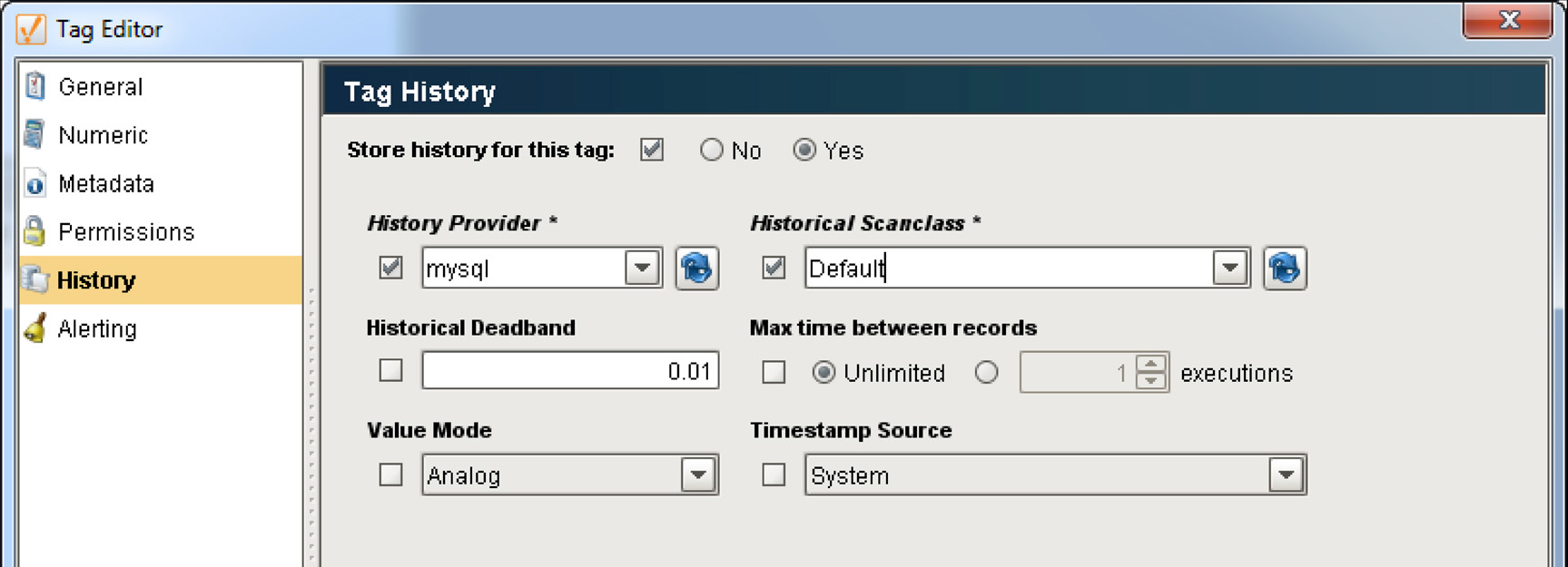

  3. Click on History on the left side of Tag Editor.
  4. Click Yes for Store history for this tag.
  5. Choose a database from the History Provider dropdown. For example, choose mysql as the database you want to log to.
  6. Choose Default for Historical Scanclass. This sets the rate at which data is logged. The default is set to 1 second which means data is logged every second.

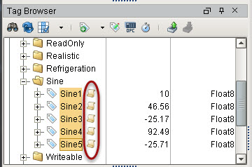

  7. Click OK. Now look in the Tag Browser, to the right of each Sine tag that is storing history, an icon appears letting you know it is setup.

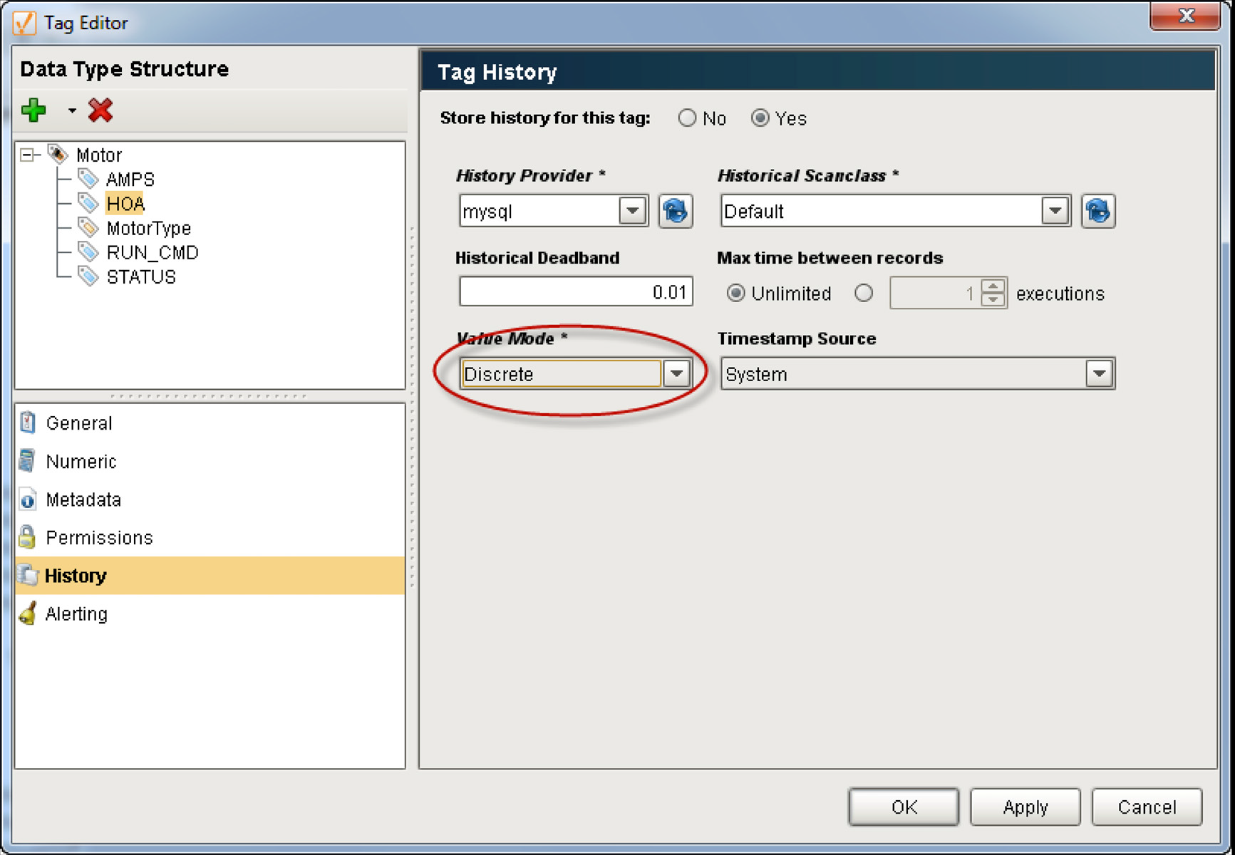

  2. In Tag Editor, click a tag (for example, the AMPS tag), select History, and set Store history for this tag to Yes.
  3. Set the following in Tag Editor and click Apply:
    • History Provider: mysql
    • Historical Scanclass: Default
    • Value Mode: Analog
  1. Do the same for the HOA tag but set Value Mode to Discrete because HOA is a discrete state.
  2. Click OK to save.
