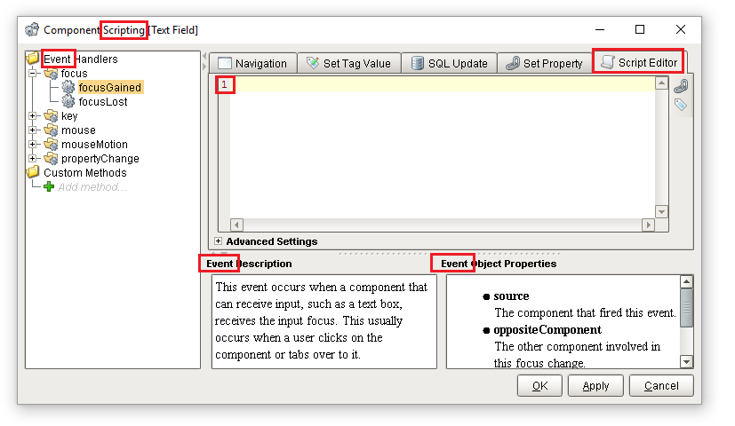

How Can I Tell If I'm Writing a Python Script?​
Python Scripts typically use the words Script or Event in the interface. Additionally, Python requires a particular Event to be selected so if you see event Handlers on the left, you know you are looking at a Python script.

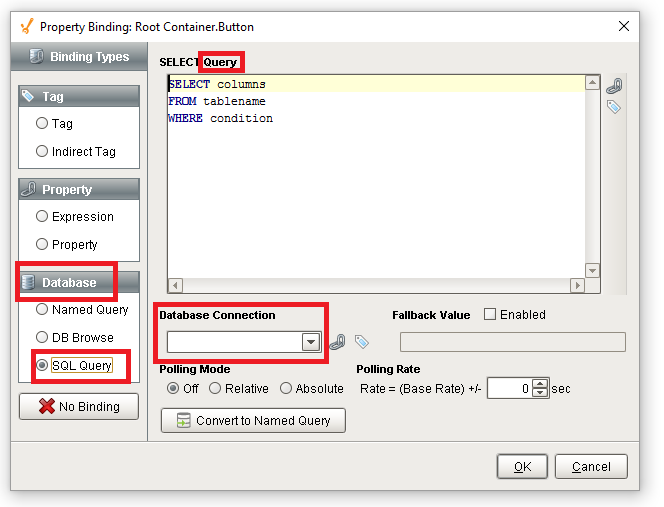

How Can I Tell If I Should Be Using SQL Syntax?​
Typically, the words Query and Database appear in the interface somewhere. Additionally, there is usually a way to specify a Database Connection.

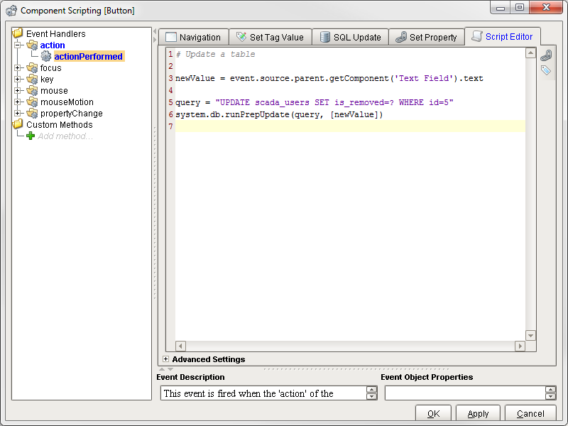

SQL queries can be called from a Python script. There are several system functions in Ignition that allow a script to run a query against the database, such as system.db.runPrepQuery. This is a more advanced technique, as you need to adhere to both language's syntax. Furthermore, when typing a SQL query in a Python script interface, the syntax highlighting can not help with the SQL portions. The syntax highlighting in a Scripting Window is only looking for Python syntax, not SQL.
In cases where you plan on calling a SQL query from a Python script, it is highly recommended to write the query in the Database Query Browser first (substituting parameters with static values for testing purposes), and then move the query over to the script once the query executes successfully on its own. This approach can save you some time troubleshooting, as there will be less ambiguity when an error occurs since you know the query runs.
Below we see an example of calling a SQL query in a script. Line 5 creates a variable called "query", and assigns it a string consisting of a prepared statement (using SQL). The query is then executed with the system.db.runPrepUpdate function.
For more examples of using a query in a Python Script, check out the system.db.* functions.

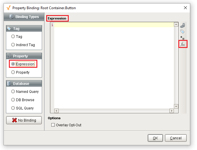

How Can I Tell If I'm Writing an Expression?​
Typically interfaces that expect the Expression Language use the word Expression. Additionally, you'll commonly find the Expression Function button towards the right side of the text area.
