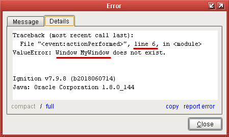

Exceptions usually include a line number. Take note of the number in the Details tab, and start your search for the problem there. Be aware, however, that the line reported may not be the cause of the issue. The actual problem may be higher up in the code due to a faulty initialization, or some other issue. When troubleshooting, always start looking at the line reported, and work your way back towards the top.

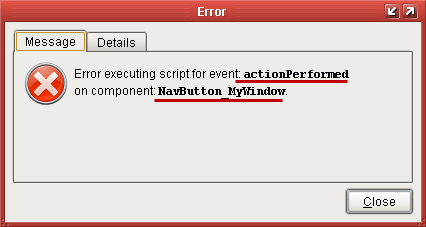

The error messages generated from failed script executions are incredibly helpful! The Message tab on the error describes the Event Handler that encountered the exception; in this case, the actionPerformed event handler. This is important in cases where multiple Event Handlers on the same component have scripts. Without knowing which Event Handler generated the script, we could waste time trying to troubleshoot the wrong script.
Additionally, it shows the name of the component, which is "NavButton_MyWindow". Again, this is helpful if multiple scripts from multiple components are triggering in quick succession. The Message tab will clearly point you towards the source of the exception. This is another reason to give meaningful names to your components: doing so makes the process of tracking an error much easier.
The Details tab has even more information, specifically the line number that the exception occurred on, as well as the error message. The message here states that the window at path "MyWindow" does not exist, so we can check the Project Browser to see if we simply mistyped the name of the window.

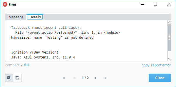

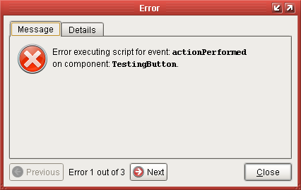

Broken Example - Undefined​
Here is a similar script that when a Button is pressed, it's supposed to open a Message Box on a window and display "Testing".
system.gui.messageBox("Testing")
The Error Message Box displays an error on the actionPerformed script on the button component in line 9 with an undefined name. The Details tab is simply telling us that something is not defined in the script. You can either define a variable or create a string by putting "Testing" in quotes to correct the error.
For this example, we corrected the code by turning the argument passed to system.gui.messageBox into a string literal with quotation marks:
