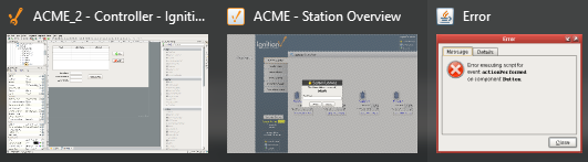

Before You Begin...​
Make absolutely certain that there isn't an Error Message Box hiding somewhere, otherwise you'll waste time applying the troubleshooting tips outlined below, when the real the error message was hiding in the background behind another window the whole time.
If a button component on a window is running a script, the output will be displayed on the Designer/Client Output Console. You can check for any error messages by navigating to the Console. From the Client menu bar, go to Help > Diagnostics and select the Console tab. From the Designer menu bar, select Tools > Console.

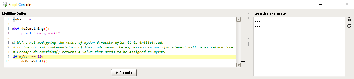

Pseudocode - Missing Code
myVar = 0
def doSomething():
print "Doing work!"
# We're not modifying the value of myVar directly after it is initialized,
# so the current implementation of this code means the expression in our if-statement will never return True.
# Perhaps doSomething() returns a value that needs to be assigned to myVar.
if myVar == 10:
doMoreStuff()
A quick way to test your code is by running your script in the Script Console before attaching it to a scripting event or specific component. You can see that running the code above in the Script Console that nothing happened, thus, suggesting an error.

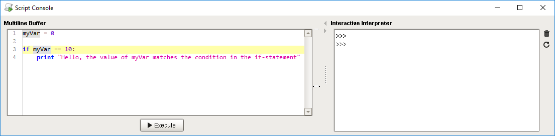

Pseudocode - Skipping Code
myVar = 0
if myVar == 10:
print "Hello, the value of myVar matches the condition in the if-statement"
Test your code for any errors by running your script in the Script Console. You can see nothing happened by running the code above in the Script Editor, once again suggesting an error.
