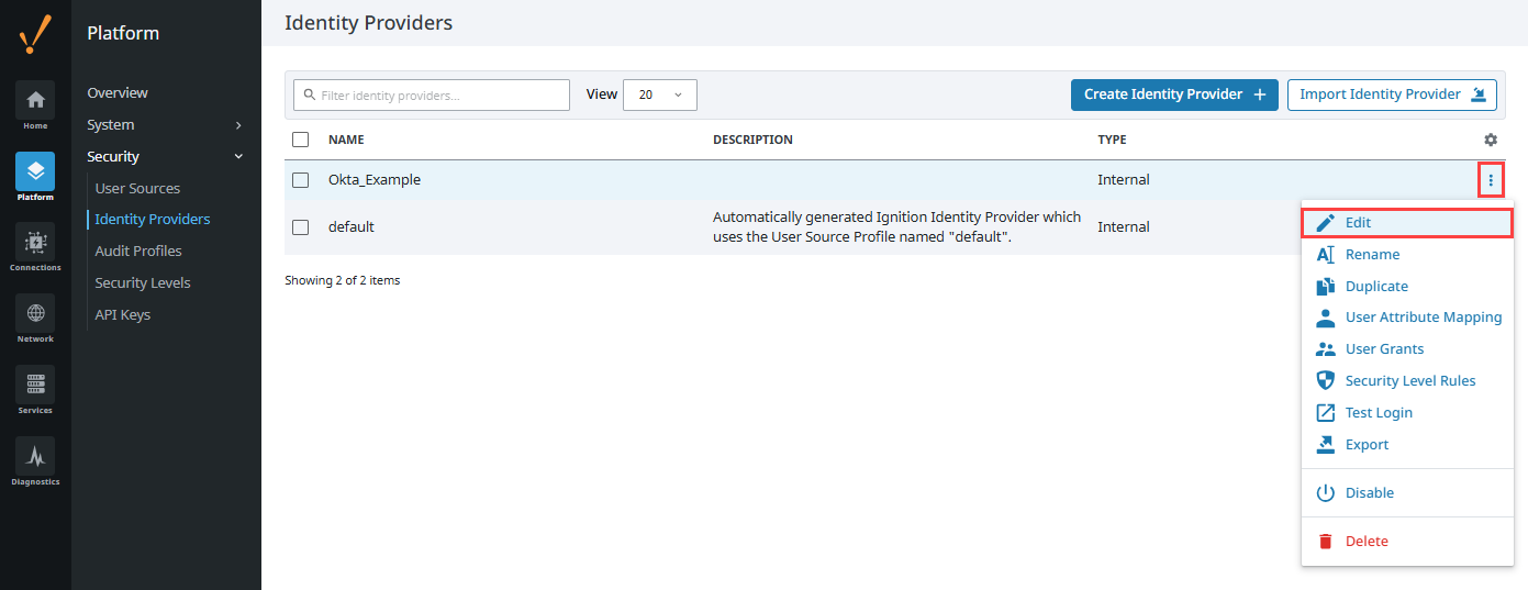

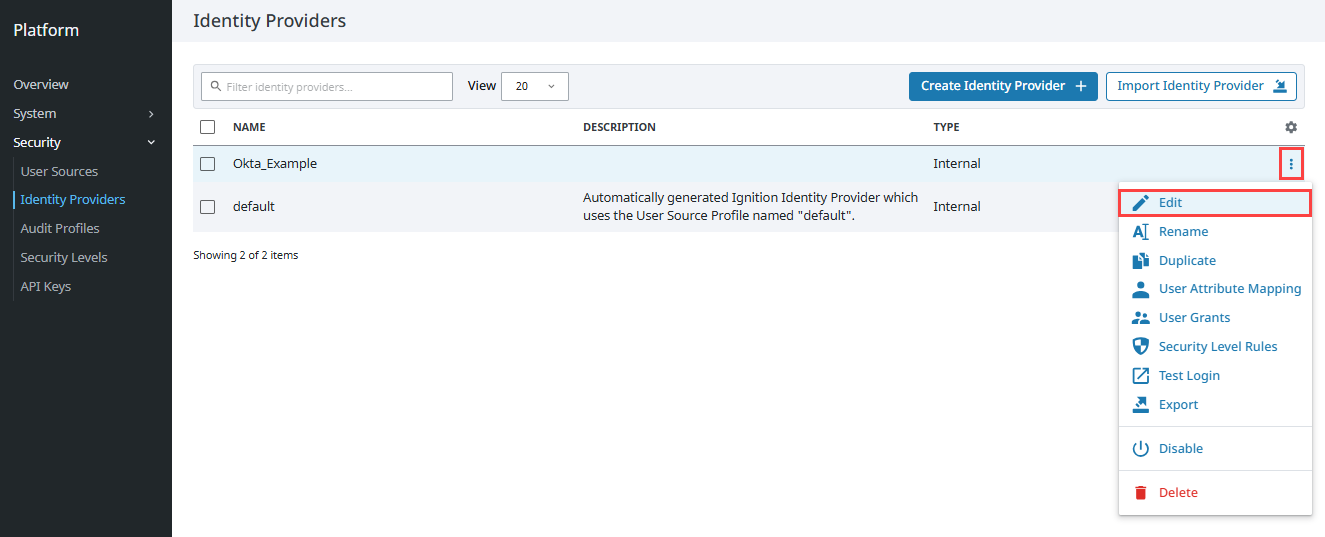

  1. Go to Edit panel for you IdP. The Edit option is available under the IdP three dots menu.
