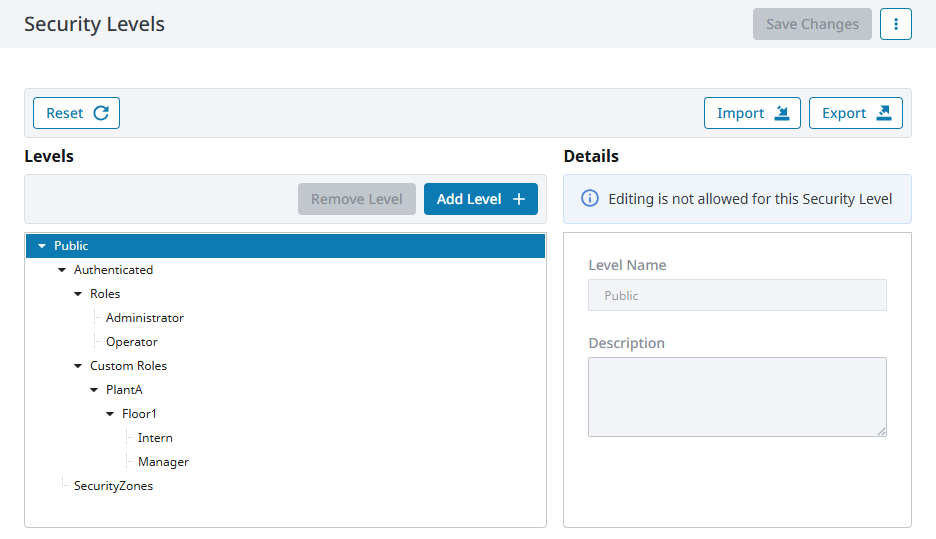

Predefined Rulesets​
One thing you may notice right away is that on the Security Level Rules page, many of the built in Security Levels are missing. Some Security Levels don't allow you to create an expression that defines their rules. These particular Security Levels already have a set of rules that govern how a user gets them. The Security Levels corresponding to the different Security Zones are automatically given to users depending on which zones they fall into. Similarly, the Security Levels that correspond to the Roles a user gets while authenticated are automatically given to users depending on what roles we receive from the Identity Provider. These Security Levels are removed from the tree here because rules can't be defined on them. The "Public" and "Authenticated" Security Levels also can't have Security Level Rules defined on them, but are present in the tree because they can potentially be a parent to custom nodes which can have Security Level Rules. The Public level is granted to every user when they open the project, and the Authenticated level is granted when the user authenticates against an Identity Provider, regardless of what roles they may have.

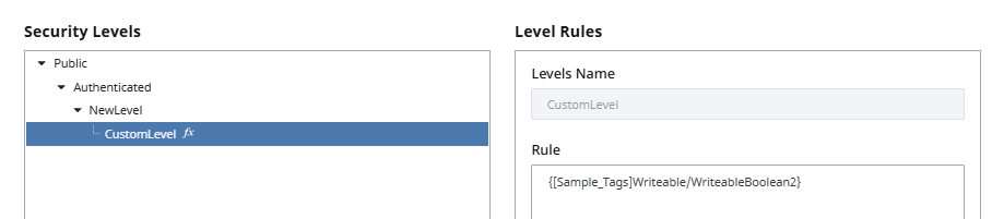

Evaluating Tag Values​
Tag values can be accessed in the Security Level Rules expression area by encasing the Tag Path (including the Tag Provider) in braces, { }
{[tagProvider]path/to/tag}
note
Security Levels are determined on initial login for each session, so if a Security Level is using an expression that references a tag value, changing the value while the session is running won't change the Security Levels applied to the users already logged in.

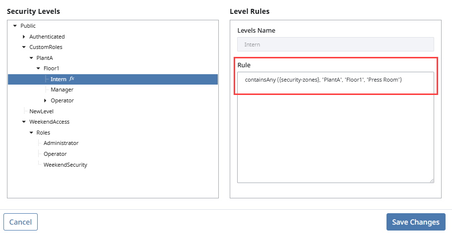

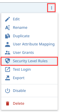

  1. From the Gateway Webpage under the Platform tab, go to Security > Identity Providers.
  2. A list of the Identity Providers will be displayed. Click the three dots menu for the Identity Provider you wand to edit, and select Security Level Rules.
  3. Select the Security Level Name and, if a rule is defined, it will appear in the Rule field. If not, you can create one. We copied the expression containsAny ({security-zones}, 'PlantA', 'Floor1', 'Press Room') from the example above for the following example.
  4. After your enter your rule, click Save Changes.
