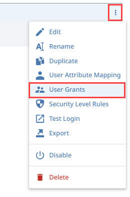

  1. From the Gateway Webpage Platform tab, click on Security > Identity Providers. The screen will refresh and you will see a list of all your IdPs.
  2. Choose the IdP and expand the three dots menu to see the actions in the dropdown list.
  3. Select User Grants.

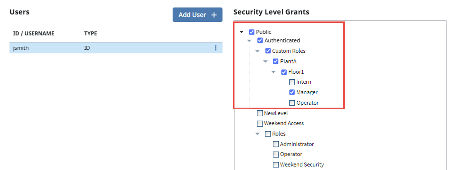

  4. To add a new user, click Add User +
  5. Choose how you will identify the user; either with a username or an ID. Click Add User to save the changes.
  6. With the user created and highlighted in the Users table, select Security Levels to grant them when they Authenticate with this Identity Provider.
  7. Click Save Changes.
Now you can test this user through the Test Login and Logout screen to verify the new roles have been assigned.
