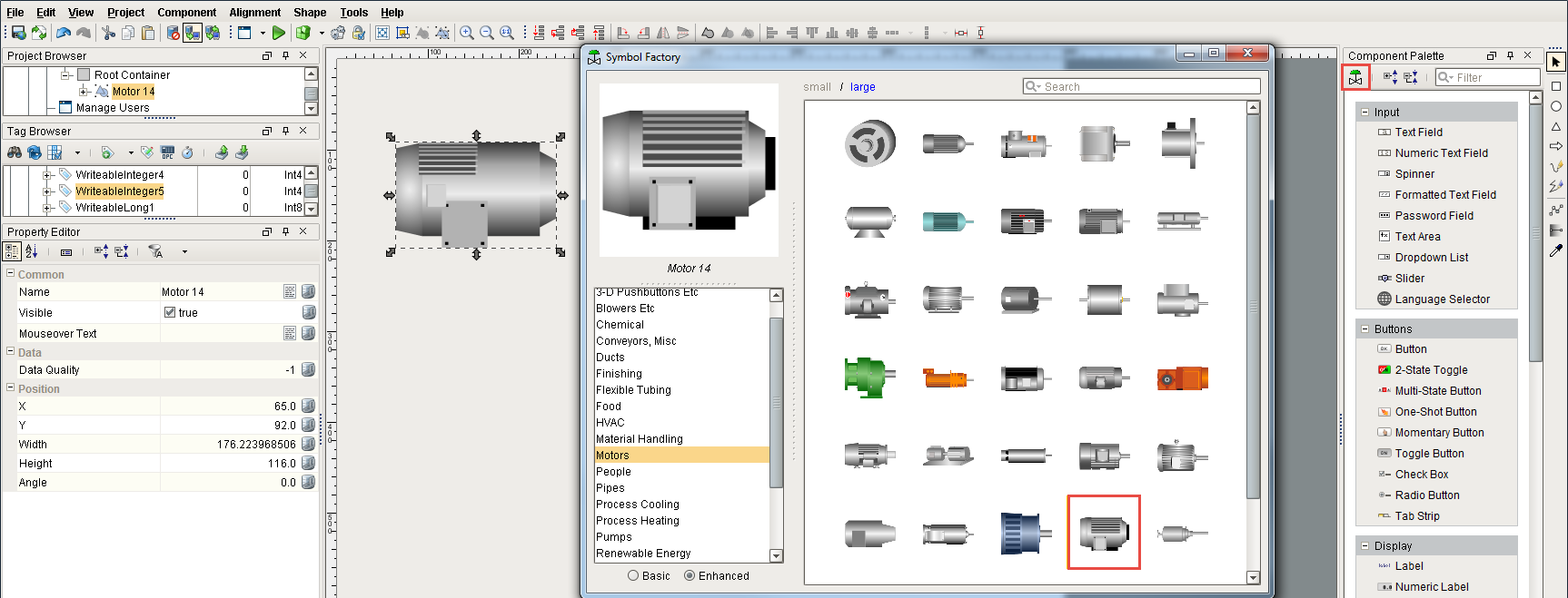

The Symbol Factory has a library of symbols to choose from. Choose your symbol and drag it to your workspace.
In Designer, open the Symbol Factory (symbol factory icon) in the Component Palette and drag a motor on to your workspace.

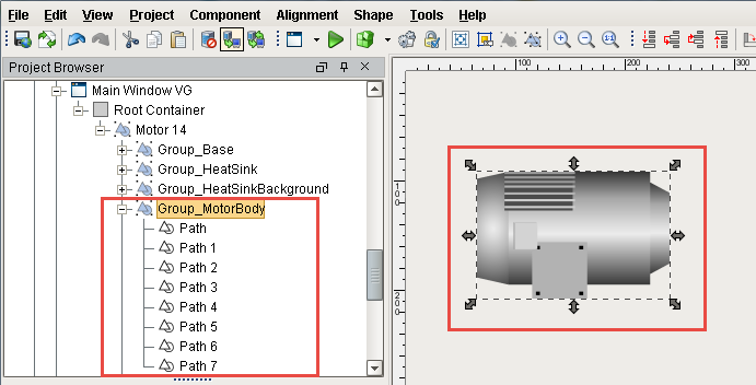

When you drag a vector graphic into a window, it’s not just one flat image, it’s actually comprised of many individual components.

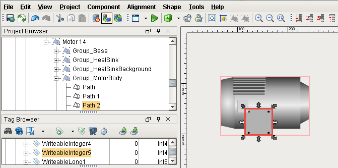

Expand the vector graphic in the Project Browser. You can see that the Motor is made up of many different components of the SVG. Each of these components can be colored independently.
selecting components of the SVG 2

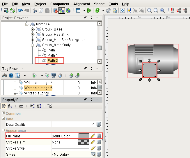

In this example, let's select the square as the individual component of the SVG. Double click on the Motor, double click the square, and then single click on the square again.
selecting components of the SVG 3
Every individual component of the SVG has a Fill Paint property that can dynamically change based on a value. Click on the Fill Paint property binding icon.
selecting components of the SVG 4
Once you have the Fill Paint selected, you can bind it to a Tag or anything else you want. Since there are a number of ways to bind the Tag, let's explore our options in the following sections.

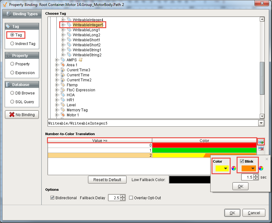

Number-to-Color- Translation Table​

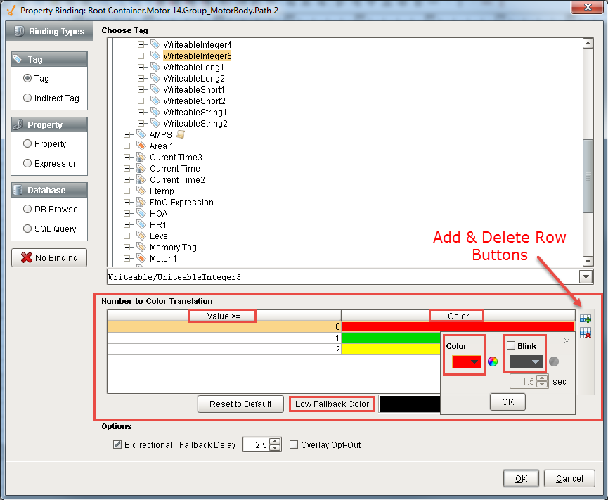

The Fill Paint property uses the Number-to-Color Translation table in Ignition, commonly known as Color Mapping. This is where you map a value to a color. For every number range there is a set color. You can choose a different color for each value, and even make it blink between two different colors. If you need to add or remove a value, simply use the add row (add row icon) and remove row icons (remove row icon) on the right side of the Number-to-Color Translation table. In this SVG example, value '0' is set to red, value '1' is set to green, and value '2' is set to blink between yellow and orange. If you are using this as a tint overlay, make sure each color is semi-transparent so you can see the actual symbol behind it. There is a Low Fallback Color option so when a value falls below your lowest value, a default color can be set.
number to color translation table
Tag Binding​
A Tag Binding is a very straight-forward binding type. It simply binds a single property directly to a Tag. For this example, every time the Tag binding is evaluated, the Fill Paint property changes, pushing the new color to the component of the SVG. To learn more about tags, refer to the section on Understanding Tags.
Bind the Fill Paint property to any numeric Tag. If you are not familiar with numeric, it's any number value. Integers are the best, but you can also use a boolean, float, etc. In this example, ‘WriteableInteger5’ was selected. Set the values in the Number-to-Color Translation table to drive the color of a component of an SVG.
  • On Value 0, make the component red by double clicking on the first row. Under Color, select red and press OK.
  • On Value 1, make the component green. Double click the second row and under Color, select green and press OK.
  • Add a row by clicking the Add Row icon (add row icon).
  • On Value 2, make the square component blink between yellow and orange. Double click the third row and check the Blink box, and select the colors yellow and orange.
  • Press OK.

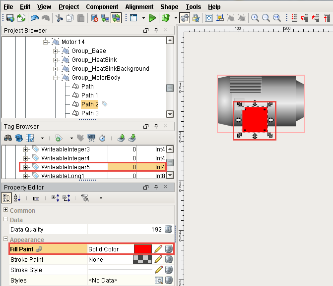

Once you press OK button, you’ll notice that the component of the SVG changed color based on the current value of the Tag. The Value is set to '0' and the color is red. To change the Tag value, go to the Tag Browser, double click on your tag value, and change the value from '0' to '1'. Press Enter. The component of the SVG will change from red to green. Now, change the Value from '1' to '2', and the color will blink yellow and orange.
Tag Binding Color Display

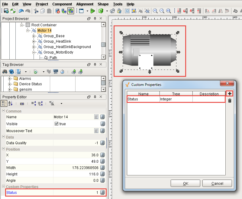

Drag in a Motor SVG and create a custom property on the Motor called 'Status'. In this example, right click on the Motor and select Customizers > Custom Properties. Enter the name 'Status' and use the default 'Integer' type. Press OK.
Property Binding Custom Properties

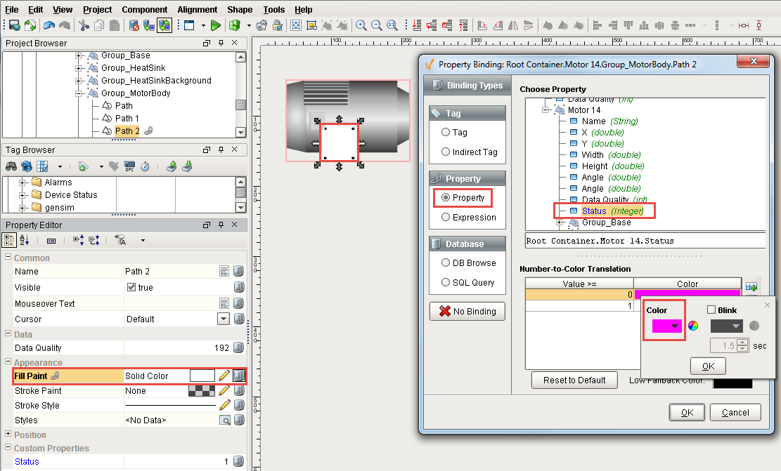

Click the Fill Property icon, and select the Property binding type. Under the Motor object, select your new 'Status (Integer)' property. Choose your colors and values. Press OK.
Property Binding Binding Window

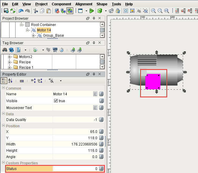

Once you press OK, you’ll notice that the square component of the SVG changed color based on the value of the tag. An Integer value defaults to '0' and in this case the color is purple. To change the tag value, go to the Property Editor, double click on the Status property value, and change the value from '0' to '1'. Press Enter. The component of the SVG will change from purple to whatever color you set '1' too.
Property Binding Display in Designer

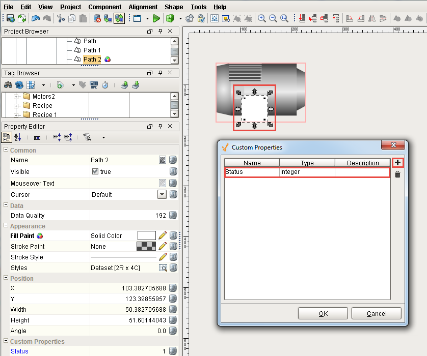

You can also use the Style Customizer to achieve the same result as with the Property Binding. Like the previous example, we will need a Status property to drive the style. Let's create that same Status property on the inner component of the SVG. Select the component of the SVG, right click and scroll down to Customizers > Custom Properties. Enter the name 'Status' and use the default 'Integer'. Press OK.
Style Customizer Custom Properties

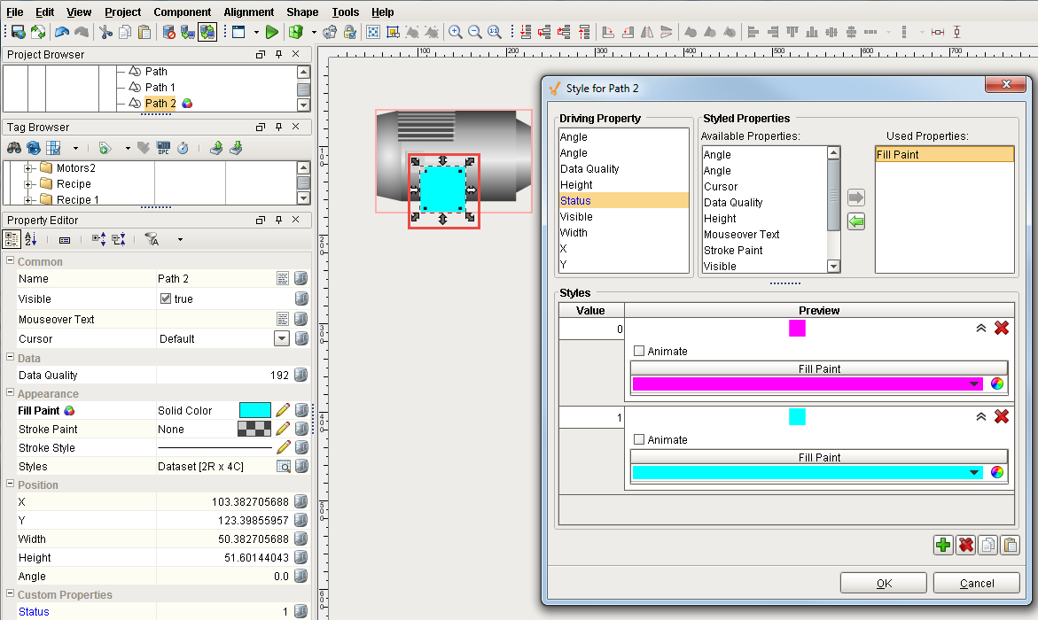

With the inner component still selected, right-click and select Customizers > Style Customizers. Select the Status property as the driving property, select Fill Paint from the list of Styled Properties, and then choose your colors for each value, adding values if needed. Press OK.
Style Customizer Style Setup
To change the Tag value, go to the Property Editor, double click on the Status property value, and change the value from '0' to '1'. Press Enter. The component of the SVG will change from purple to whatever color you set it too.
