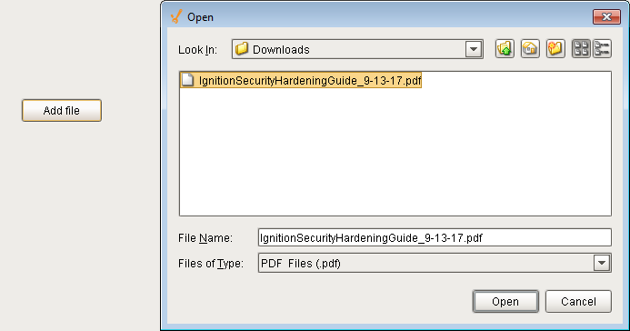

    1. Navigate to the Script Editor Tab of the actionPerformed Event Handler. Here we can put a script that will grab the file bytes using the file path and the system.file.readFileAsBytes function, and then insert that into the database, along with a user selected file name.
Python - Uploads PDF Files to a Database Using a Button
# Find the path to the PDF file.
path = system.file.openFile("pdf")
# Check to ensure that the user actually selected a filepath.
if path != None:
# Read the file as bytes.
data = system.file.readFileAsBytes(path)

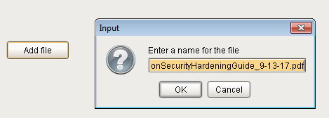

# Ask the user to enter in a filename.
# Will grab just the filename and extension from the path as a suggestion.
name = system.gui.inputBox("Enter a name for the file", path.split('\\')[-1])
# Check to ensure that the user entered a name for the file.
if name != None:
# Insert the data and name into the database.
system.db.runPrepUpdate("INSERT INTO files (fileName, fileBytes) VALUES (?,?)", [name,data])
  1. Test out the script by putting the Designer into Preview Mode and clicking the Button.
    1. First, select the file to load.
    2. Then enter in a file name.

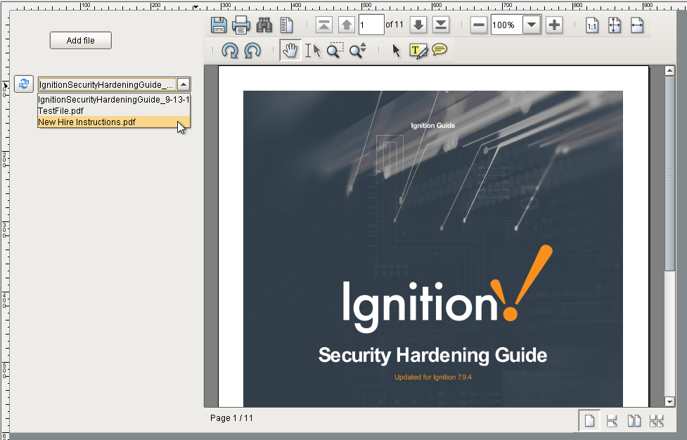

  1. On the Main Window, add a Dropdown component and a PDF Viewer component.
  2. On the Dropdown component, add a Named Query binding to the Data property.
    1. Set the binding to the Named Query that was made in step 1.
    2. Place a small refresh Button next to the Dropdown that will refresh this query. See Refreshing a SQL Query for more information for how to refresh on a button.
  3. Right click on the Dropdown component and select Scripting.
    2. This script will take any new selected value and use it in the Named Query we made in step 2 to get the file name and bytes. We can then load the bytes into the PDF Viewer.
Python - Displays PDF Files from a Database Using the PDF Viewer
# Check to see if the property that changed was the Selected Value property.
if event.propertyName == "selectedValue":
# Run the query to grab the file name and bytes using the new selected ID value.
system.db.runNamedQuery("Read File", {"fileID":event.newValue})
# Grab the file bytes and name from the same row.
bytes = data.getValueAt(0, "fileBytes")
name = data.getValueAt(0, "fileName")
# Load the bytes into the PDF Viewer component.
event.source.parent.getComponent('PDF Viewer').loadPDFBytes(bytes, name)
  1. Place the Designer into Preview Mode, and try selecting one of the stored files.
