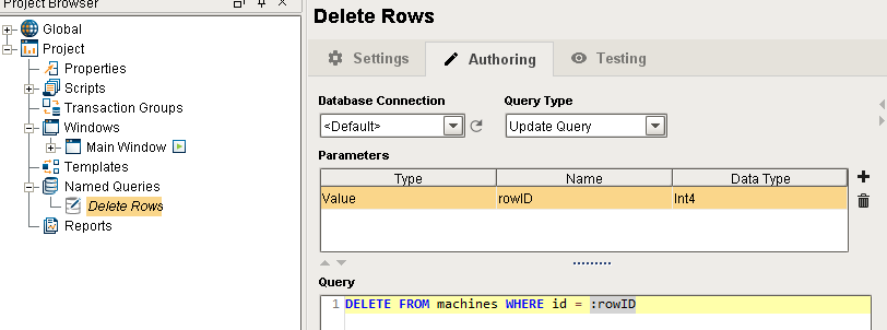

  1. Create a new Named Query that will be used to delete rows of data. Setup Security to fit your needs, and name it appropriately. For more information on creating Named Queries, see Using Named Queries - Example.
    1. Set the Query Type to Update Query.
    2. Create a single Value type Parameter that is an Int4 data type. This will hold the id of the row, so we can name it rowID.
    3. Create the Delete Query.
SQL - Delete Row with Matching ID
DELETE FROM machines WHERE id = :rowID
