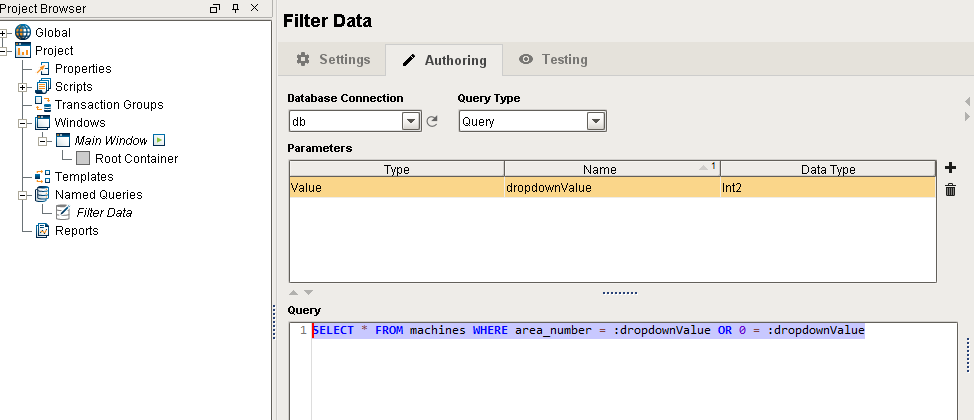

  1. Create a new Named Query. Set up security to fit your needs, and name it appropriately. For more information on creating Named Queries, see Using Named Queries - Example.
    1. Create a single Value type Parameter that is an Int2 data type. I called mine dropdownValue
    2. Add in the combined query that we went over above, but use the machine table name and column names.
SQL - Selecting Values from a Table and Filtering on a Dropdown
SELECT * FROM machines WHERE area_number = :dropdownValue OR 0 = :dropdownValue

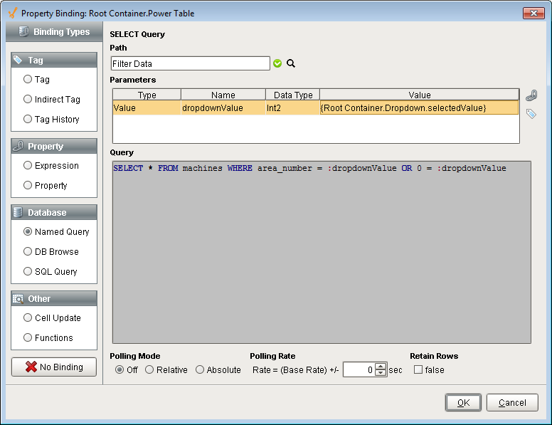

  1. Create a new Main Window and add a Power Table component and a Dropdown component to the window.

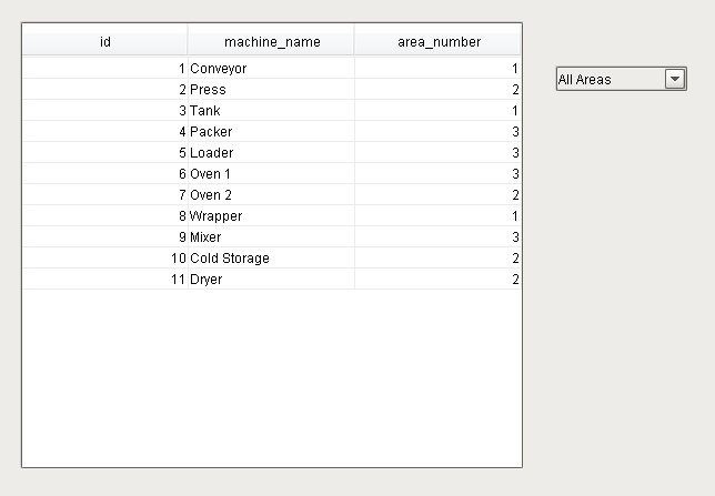

    1. On the Dropdown's Data property, create a dataset that looks like this: |Value|Label| |:---|:---| |1|Area 1| |2|Area 2| |3|Area 3| |0|All Areas|
  2. On the Power Table component, create a Named Query Binding on the Data property.
    1. Select the Named Query that was created in step 1.
    2. For the parameter, bind its value to the Selected Value property of the Dropdown component, and the click the OK button.
  3. Put the Designer into preview mode and try out the Dropdown Filter. You will see that selecting a different value in the dropdown filters the data coming back so that only certain rows are shown.
