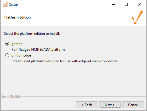

The Installation Mode window is displayed.
Select the platform you wish to install. The rest of this guide will use Ignition as the platform.
Select either the Typical or Custom mode.

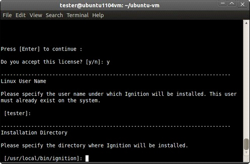

Ensure the installation directory is the default directory at
/user/local/bin/ignition:
Specify the user name under which Ignition is to be installed. For Ubuntu installations, the user that invoked sudo is used by default. For other Linux installations, this field is initially blank.
noteThe Linux installer requires a user name to set the permissions on the folders created by the installer. This user is then able to start and stop Ignition, run the Gateway Control Utility, and the command line interfaces.
The binaries in the installation folder are still owned by root and cannot be modified without root access. The selected user must already exist on the system before starting the installer.
