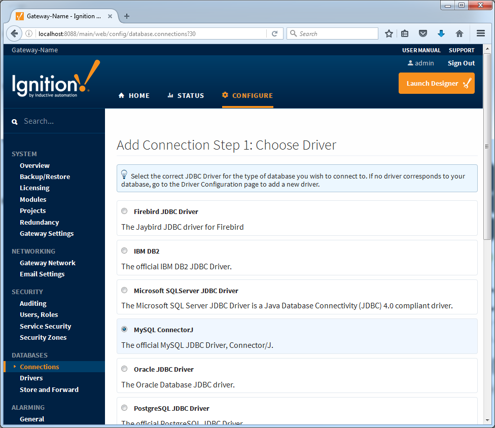

  1. Log into the Configure section of the Gateway Webpage just like in the previous sections.
  2. Navigate to the Databases Connections page.
  3. Click the Create new Database Connection... link.
  4. Select the MySQL ConnectorJ option and click the Next > button.

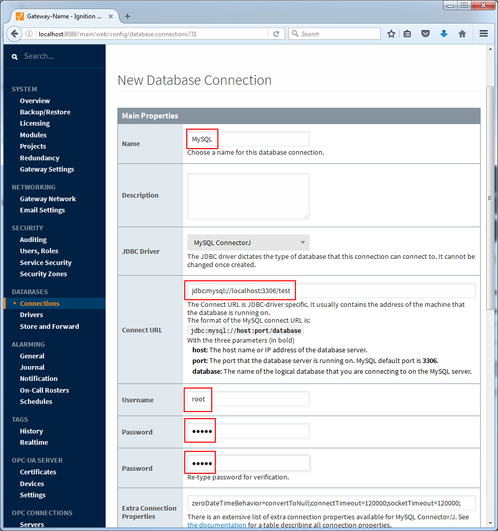

  5. Enter a Name, Connect URL, username, and password. If you just installed MySQL on the same machine as Ignition you will be able to use the following credentials:
    Connect URL: jdbc:mysql://localhost:3306/test
    Username: root
    Password: [whatever password you entered when installing MySQL]

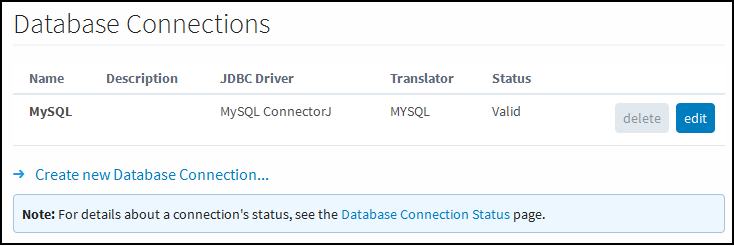

    Scroll to the bottom and click the Create new Database Connection button.
Learn more about Database Connections
