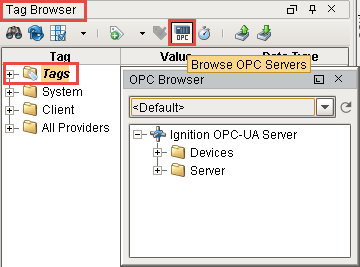

  1. In the Tag Browser, select the Tags folder then click the Browse OPC Servers icon.
    The OPC Browser is displayed and you can browse all of your OPC connections.

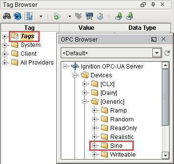

  2. From the OPC Browser, highlight the Tags you want (for example, as in the picture below, the entire Sine folder is selected) and drag them to the Tags folder in the Tag Browser.
    You can drag individual Tags or whole folders. When you drag folders, Ignition keeps the same hierarchy as the PLC.

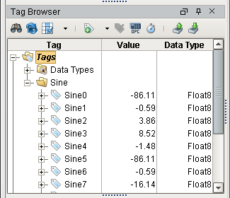

  3. That's it! You now have some Tags. Expand the Tags folder and the new Sine folder to see what you have added. You can see their values come in and start updating automatically. By default, they update at a 1 second rate.
