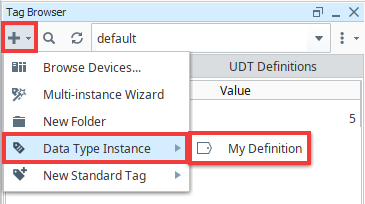

Creating an Instanceβ
Now that we have a UDT Definition, we can create a UDT Instance. You can use the Multi-Instance Wizard to make many instances quickly, but you can also create a single instance.
- In the Tag Browser, switch back to the Tags tab. This section of the Tag Browser is where you create UDT instances. Definitions can not be placed in this section.
- Click the Add icon and hover the mouse cursor over Data Type Instance. This will expand and show all of the UDT Definitions that exist within the active Tag Provider. Select the Definition we created in the previous example.
- Again, the Tag Editor will open. This time allowing you to edit an instance of the UDT. From here you can name the Instance. In this case we'll use the name "New Instance".
- If you select the member ("A Memory Tag"), you'll notice that many of the properties have a grey dot. This signifies that the properties are inheriting their values from the definition.
- We won't make any changes here. Just click OK, which closes the Tag Editor and creates a UDT instance.
