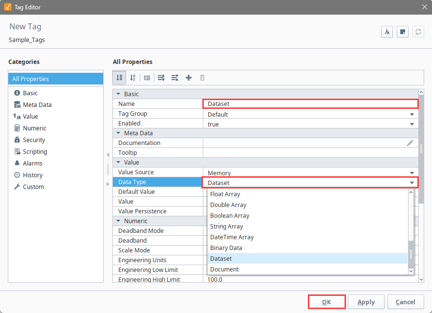

    1. Create a new Memory Tag. Name it Dataset, and change the data type to Dataset. The Dataset will be empty by default.

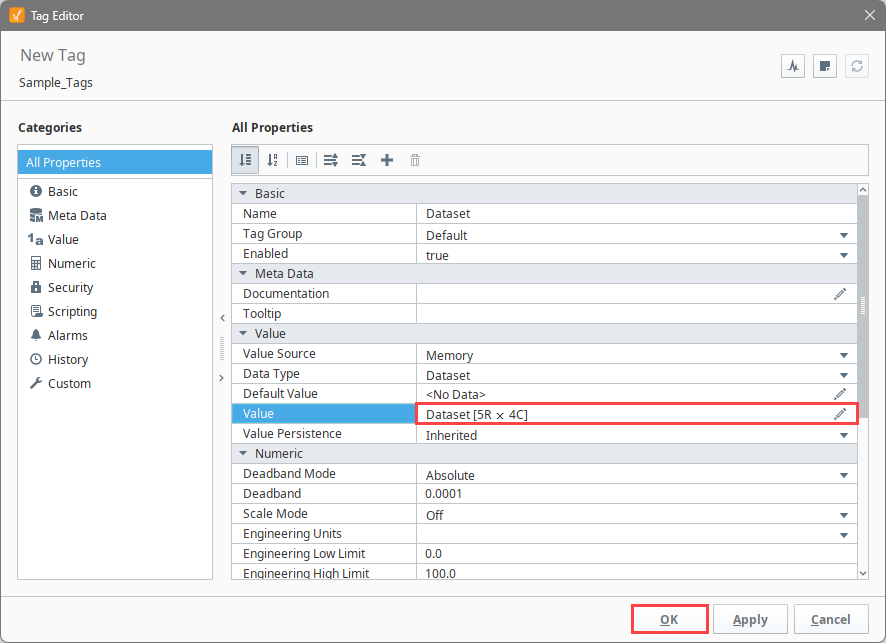

    2. Click the Edit icon next to Value. The Value screen is displayed. For this example, we created a simple dataset with four columns and five rows.
    3. Click the Add Column icon. Name the first column City and set type to be String.
    4. Click Add Column.
    5. Repeat adding columns as follows:
      • Column Name: Population Type: Integer
      • Column Name: TimeZone Type: String
      • Column Name: GMTOffset Type: Integer
    6. Click the Add Row icon. Add the row information as follows:
      New York8368710EST-5
      Los Angeles3833995PST-8
      Chicago2853114CST-6
      Houston2242193CST-6
      Phoenix1567924MST-7
    7. Click the Commit button.
    8. Click OK to save the tag.
    The tag will now contain rows, columns, and values based on the configurations you made earlier in this example. Now you have a tag with a dataset value that can be bound to by components in Vision and Perspective.
