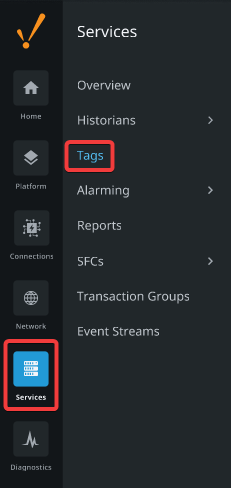

  1. Navigate to the Services > Tags section on the Gateway to access the Realtime Tag Providers page.

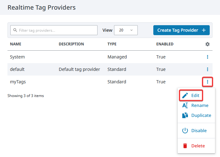

  2. Click on the three dots menu for the provider you want to enable/disable the Tag Reference Tracker Store setting for, then click Edit.

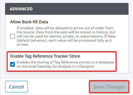

  3. Scroll down the settings to the bottom to locate the Enable Tag Reference Tracker Store setting. If this property is checked, it is enabled. If you need to change the setting, toggle the check box, then click Save Changes.

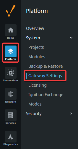

  1. Navigate to Platform > System > Gateway Settings on the Gateway to access the System Settings page.

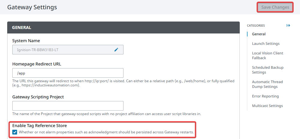

  2. Find the Enable Tag Reference Tracker Store property. If it is checked, the property is enabled. If you need to change the setting, toggle the check box, then click Save Changes.
    Managed Tag Providers Step 2
  3. Be prepared that this setting impacts all managed providers throughout the Gateway, so a large number of third party modules can result in large data collections.
