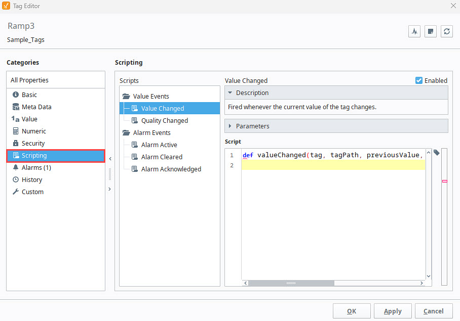

Scripts can be attached to tags. When you edit a tag, you can navigate to the Tag Events section and click on the Edit icon to see a list of all of the available events. Those events are

Event Options​
Once an event has been selected, note that the top of the text area is defining a function. As a result, all code that should execute when this event occurs should be indented at least once to be included in the definition.
