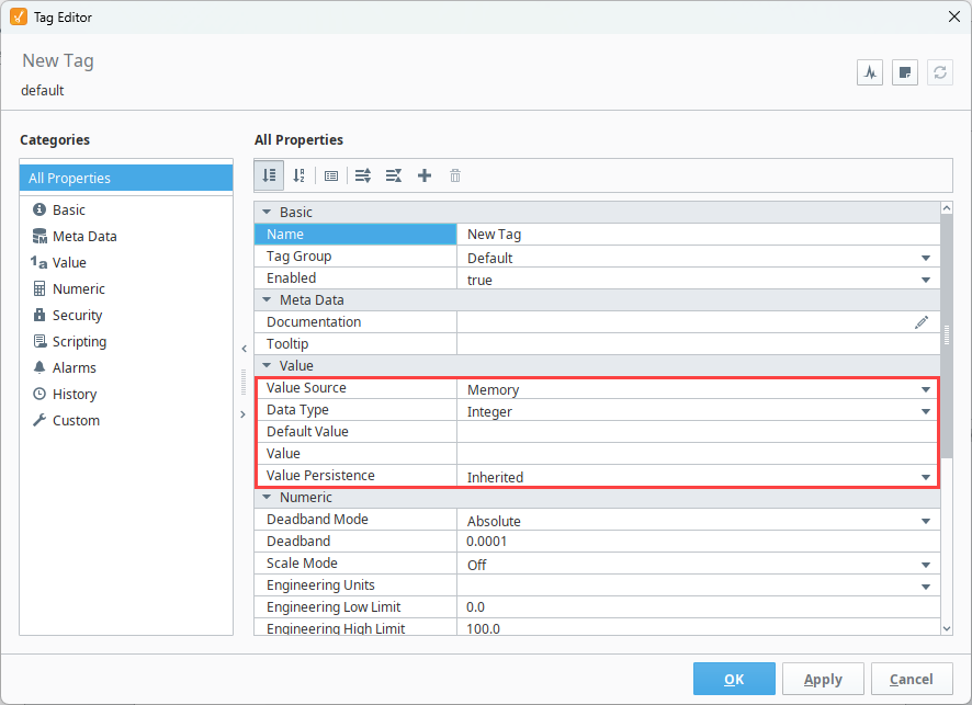

Memory tags are simple tags, that do not automatically poll or update their value. They hold the same value until some other user-created mechanism (most likely a script or binding) changes their value. They're useful in situations where a value must be stored outside of a PLC or database.
The Value Persistence setting determines how the Memory tag values are stored. This option will impact whether the tag value is retained across Gateway restarts.
