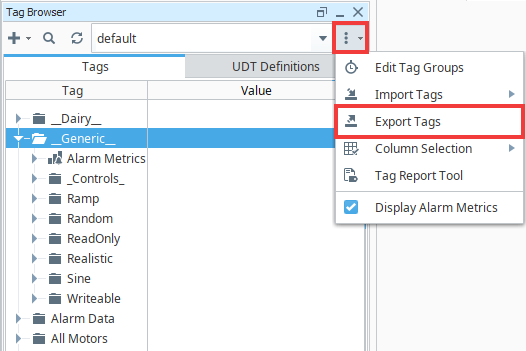

  1. On the Tag Browser toolbar, click the More Options menu to open the dropdown. Select Export Tags.
Export Tags Step 1
