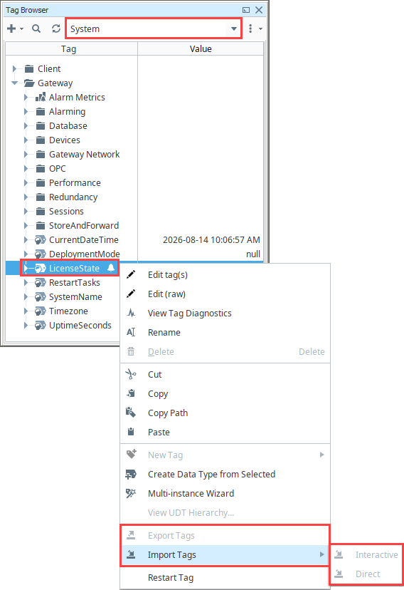

There may be instances where you want to export the configuration of a System Tag. Unlike regular tags from a Tag Provider however, the built-in import and export functionality is disabled for System Tags.
System Tag Import and Export Functions Disabled

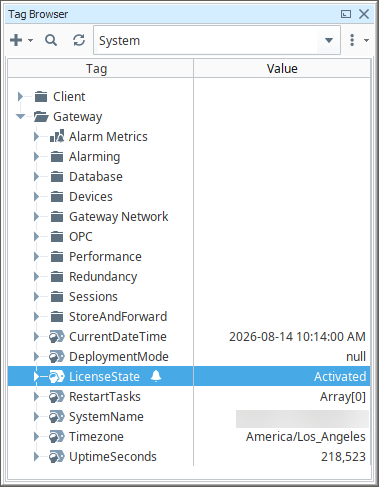

As a result, we will use both scripting and system functions to import or export the configurations we want. In each of the examples below, we have configured a single alarm on the LicenseState tag that we want to export and import to another Gateway, located in the Tag Browser under [System] > Gateway > LicenseState.
LicenseState Alarm in Tag Browser

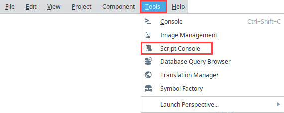

  1. Open the Script Console in the Ignition Designer.
    Script Console Location in Menubar

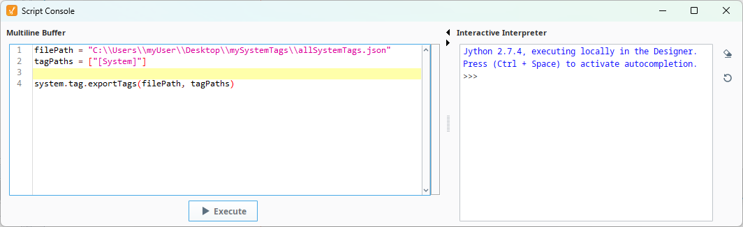

  2. Use the system.tag.exportTags() function to export your System Tags. We can use the following script, replacing the filePath parameter with the filePath you want to export to:
    Export System Tags Script
    filePath = "C:\\Users\\bau\\Desktop\\mySystemTags\\allSystemTags.json"
    tagPaths = ["[System]"]
    system.tag.exportTags(filePath, tagPaths)
    Export All System Tag Configurations Script
  3. You should now have a file containing your tags in JSON called allSystemTags.json, located at the specified file path.

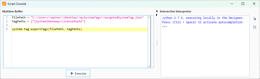

  2. Use the system.tag.exportTags() function to export the LicenseState System Tag. We can use the following script, replacing the filePath parameter with the filePath you want to export to:
    Export LicenseState Tag Script
    filePath = "C:\\Users\\bau\\Desktop\\mySystemTags\\targetedSystemTag.json"
    tagPaths = ["[System]Gateway/LicenseState"]
    Export Targeted System Tag Configuration Script
  3. You should now have a file containing the LicenseState tag in JSON called targetedSystemTag.json, located at the specified file path.

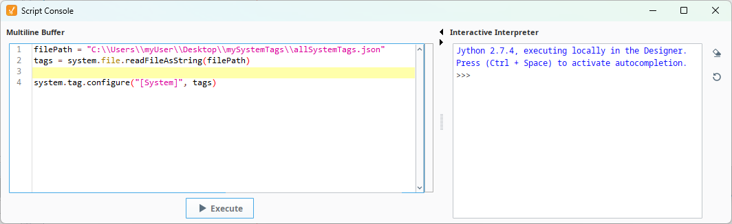

  2. Use the system.tag.configure() function to import the allSystemTags.json file. We can use the following script, replacing the filePath parameter with the path your .json file is located at:
    Import allSystemTags.json File Script
    tags = system.file.readFileAsString(filePath)
    system.tag.configure("[System]", tags)
    Import All System Tag Configurations Script
  3. Your System Tags should now be updated with the imported System Tags' configurations.

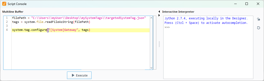

Importing a Targeted System Tag​
The steps below demonstrate how to import configurations for a single, targeted System Tag. In this section, we are assuming the targetedSystemTag.json file from the Exporting a Targeted System Tag example is accessible locally on the system importing the System Tag configuration, and inside a folder called mySystemTags.
  2. Use the system.tag.configure() function to import the targetedSystemTag.json file. We can use the following script, replacing the filePath parameter with the path your .json file is located at:
    Import targetedSystemTag.json File Script
    # Note that unlike the previous example where we imported all the System Tags to the [System] provider,
    # we need to specify the exact directory where our targeted tag lives.
    system.tag.configure("[System]Gateway", tags)
    Import Targeted System Tag Configuration Script
