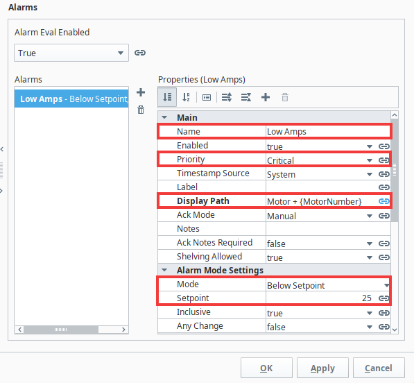

Enter an Alarm Name, Display Path, Priority, Mode, and Setpoint. UDT configurations are set up the same way as the normal alarm configuration on a tag.
Display PathIn this example, since you have multiple instances of a Motor, you need to make sure that the Display Path is unique for every instance. Otherwise, every instance of the UDT will have the same Display Path name, and the operator won't know which Motor alarm to respond to. There are a couple of ways to address this. You can leave the Display Path blank, in which case, Ignition will use the full Display Path to the instance of that tag, or you can bind a property to an expression involving a UDT parameter (i.e.,
Motor+{MotorNumber}). -
Click Apply to save your alarm edits.
Click OK to save your Motor UDT edits.
Now, all instances of the UDT will have a similar alarm setup, but each alarm can be unique to that UDT instance by changing the Below Setpoint value.

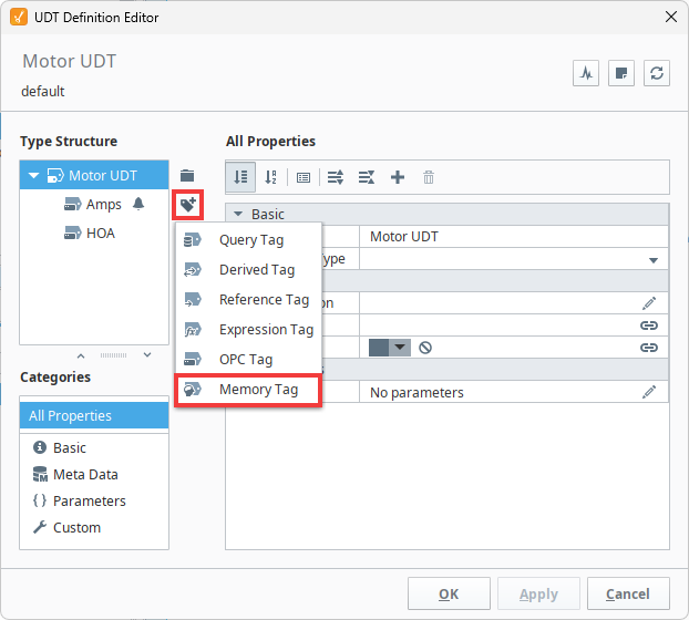

In the Tag Browser, go to the UDT Definitions tab, and double-click on your UDT to edit the definition.
Click the Add Tag
icon and select Memory Tag from the dropdown.

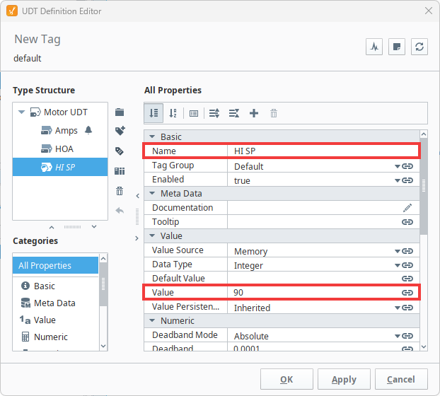

Enter the Name of the tag (HI SP) and a Value (90).
Click Apply to save your changes.

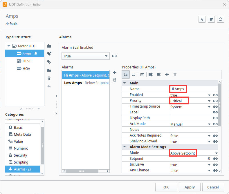

In the Type Structure area, select the tag you want to associate with the dynamic setpoint (i.e., Amps).
Under the Properties table, scroll down to Alarms. Click on the Edit
icon next to Alarms.
Click on the Add icon to create a new alarm for the high setpoint and name it Hi Amps.
Set the Priority as Critical and the Alarm Mode as Above Setpoint.

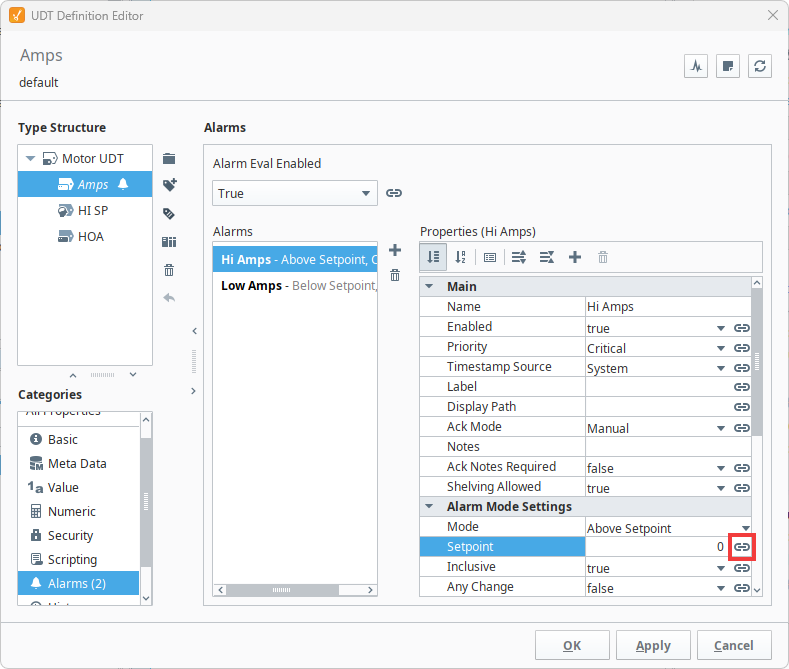

Bind the Setpoint property to the new UDT Memory tag (HI SP) by clicking on the binding
icon.

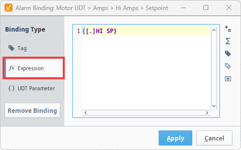

You can either create an Expression binding or use a Tag binding to select the HI SP Memory tag. This example uses an expression as shown in the image below.
Click Apply to save the expression.

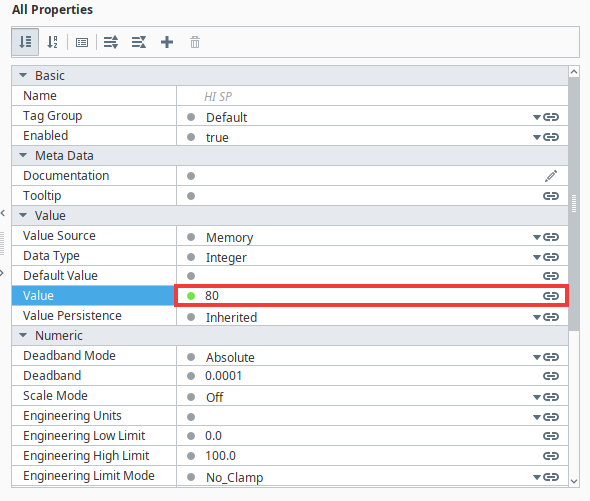

In the Tag Browser, go to the Tags tab and double-click your UDT instance to edit it. In this example, we will edit Motor 1.
In the Type Structure area, select the tag you want to override the properties for. We will chose HI SP.
Go down to the Value property and change it to the desired value. We will change our Value to 80.
Note that the gray circle next to the Value property has turned green. This indicates that Ignition detects an overridden value for that property.
Once you finish configuring your properties, click Apply and then OK.
Our Motor 1 instance is now using a different high setpoint than our other Motor instances. You can also confirm that the the HI SP tag has an override because of the half-filled circle in the Tag Browser ().
