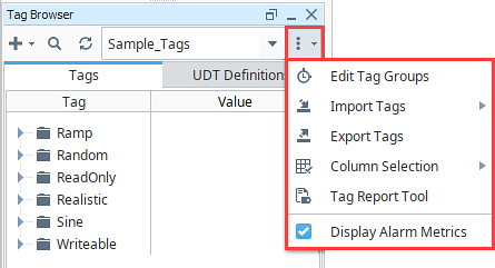

More Options Menu​
A More options icon on the upper right of the Tag Browser, opens a dropdown menu of additional options.
Tag Groups​
In the Tag Browser, the Edit Tag Groups opens the Tag Group Editor window. Tag Groups dictate the rate of execution of tags. This is where you set up your Tag Groups and scan rates. See Tag Groups for more information.
Import/Export​
Ignition can export and import tag configurations to and from the JSON ( JavaScript Object Notation ) file format. Use the Import icon or Export icon to import and export tags in the Gateway. See Exporting and Importing Tags for more information.

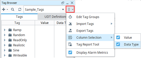

Column Selector​
The Tag Browser displays the Value and Data Type. The Value type is set by default. To toggle any of the options, click on the Column Selection icon, then click the checkbox. In the example below, the Data Type is enabled.
Tag Report Tool​
Ignition allows users to search for tags by tag path, quality, type, traits, and values through the Tag Report Tool. Click on Tag Report Tool to open the editor and begin configuring a search within the currently selected Tag Provider.
Display Alarm Metrics​
The Tag Browser displays the Alarm Metrics values by default. To change the visibility of Alarm Metrics, toggle the Display Alarm Metrics checkbox as needed.
