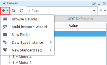

  • The Add menu in the Tag Browser toolbar.

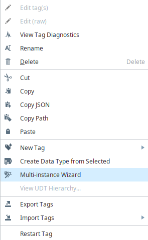

  • The right-click menu in the Tag Browser tree.
Selecting the Multi-Instance Wizard option from either location will open the Multi-Instance Creation Wizard.

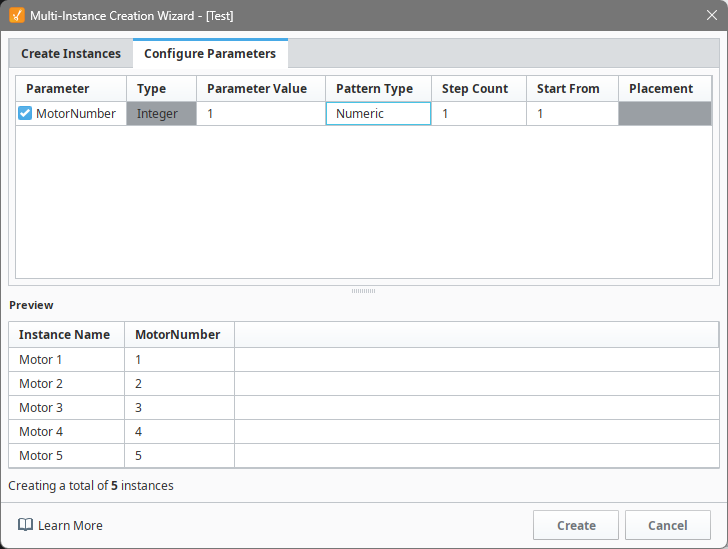

Configure Parameters
If the selected UDT includes parameters, the Configure Parameters tab becomes available. By default, parameters inherit values from the UDT definition. To override them, you can enable and configure them using the Parameter Table.
ColumnDescription
ParameterThe name of the UDT parameter. Includes a checkbox to enable overriding the default value.
TypeThe data type of the parameter.
Parameter ValueThe value to assign. This field becomes editable when the parameter is enabled.
Pattern TypeDefines how the parameter value will be applied. Options include None, Numeric, and Manual Entry.
Step CountApplicable to numeric patterns. Defines the interval between values.
Start FromThe starting value for the numeric pattern.
PlacementSpecifies whether the value should appear before or after the base string value (e.g., 1Motor vs. Motor1). Applies to string concatenation.
Use this table to specify parameter values per instance or apply patterns dynamically.

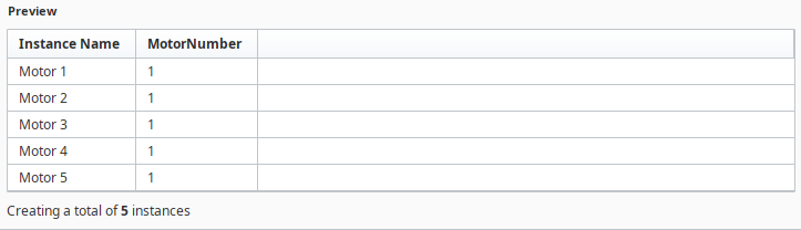

Preview Table
The preview table displays a live preview of the instances that will be created. This includes:
  • Instance Name: The full name of each instance as it will appear in the Tag Browser.
  • <parameterName>: A column for each UDT parameter. Shows inherited or overridden values per instance.
This preview updates in real time as you modify the base name, pattern configuration, or parameter values.

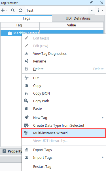

  2. Right-click on the Machine Motors folder, and select Multi-Instance Wizard to open the Multi-Instance Creation Wizard.

  6. The Preview table dynamically updates, showing how instance names and parameter values will be applied.
  7. If the selected UDT has parameters, the Configure Parameters tab will be visible. To configure:
    • Check the parameter to enable configuration.
    • Choose a Pattern Type (Numeric).
    • Enter a custom value or pattern.

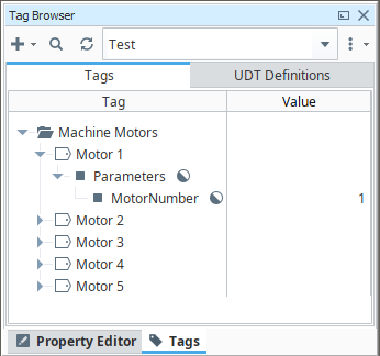

  8. Verify the created instances in the Tag Browser.
