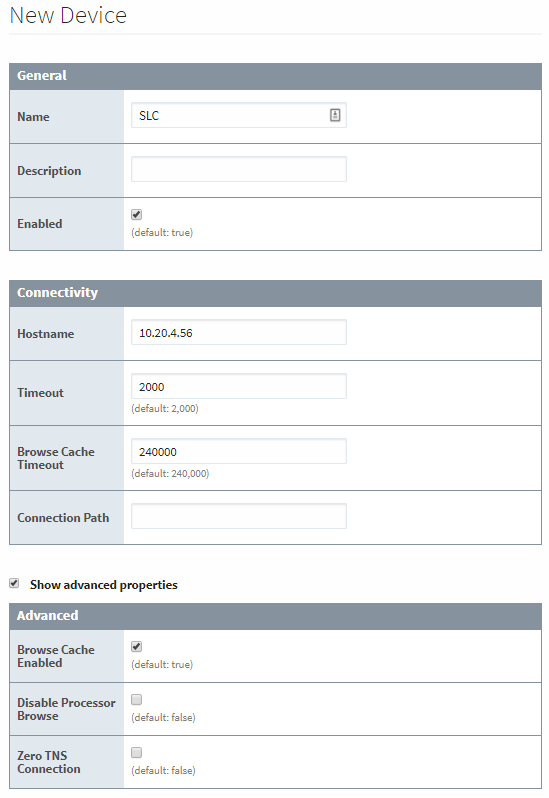

Connect to a Device​
  1. Go to the Configure section of the Gateway webpage.
  2. Scroll down and select OPC-UA Server > Devices.
  3. On the Devices page, find the blue arrow and click on Create new Device.
  4. On the Add Device Step 1: Choose Type page, select Allen-Bradley SLC, and click Next.
  5. On the New Device page, leave all the default values and type in the following fields:
    • Name: SLC
    • Hostname: type the IP address for the PLC
  6. Click Create New Device. The Devices page is displayed showing the SLC device is added to Ignition. The Status will show as Disconnected and then Connected.
  7. To see all the tags, navigate to the Configure section of the gateway, and click on Quick Client under OPC Connections. On the OPC Quick Client page, expand the folder matching the name used in step 5, and expand the Global folder to see available tags.

Connectivity Settings​
NameDescription
HostnameThe Hostname value is the IP Address of the SLC processor. The protocol that the SLC processor supports is automatically detected. It will use either CSP protocol on port 2222 (0x8AE) or EthernetIP protocol on port 44818 (0xAF12).
Communication TimeoutAfter sending a request to the SLC processor, the Communication Timeout setting is the amount of time in milliseconds to wait for a response before treating it as a failure.
Browse Cache TimeoutWhen the data table layout is read from the SLC processor, the Browse Cache Timeout value is the amount of time in milliseconds to cache the results.
Connection PathThe Connection Path value is used to define the route of the SLC processor to connect to. Currently routing through the ControlLogix Ethernet Communication Interface Module (1756-ENET) to the ControlLogix Data Highway Plus-Remote I/O Communication Interface Module (1756-DHRIO) and on to a SLC processor of the DH+ network is supported. For a more in depth explanation of connection paths, see Allen Bradley Connection Paths Explained section.
