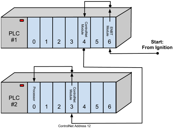

Connecting to a PLC Through ControlNet​
The example below connects to a PLC5 using ControlNet that has a connection path of 1,4,2,12,1,0 going from PLC 1 to PLC 2. The device driver is the Allen-Bradley PLC5, and the hostname is the IP address of the ControlLogix Gateway (PLC #1).
| Number/Entry | Description |
| 1 | Move out of ENBT Module to the backplane |
| 4 | Move to ControlNet Module in Slot 4 |
| 2 | Move out ControlNet Port |
| 12 | Move in ControlNet Module at ControlNet Address 12 |
| 1 | Move out of ControlNet to the backplane |
| 0 | Move to the Processor in Slot 0 |

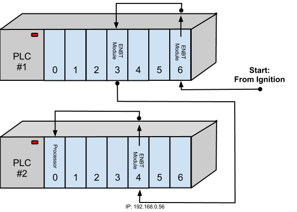

Connecting to a PLC Using ENBT​
The example below connects to a ControlLogix using ENBT that has a connection path of 1,3,2,192.168.0.56,1,0 going from PLC 1 to PLC 2. The device driver is the Allen-Bradley ControlLogix, and the hostname is the IP address of the ControlLogix Gateway (PLC #1).
| 3 | Move to ENBT Module in Slot 3 |
| 2 | Move out the Ethernet Port |
| 192.168.0.56 | Move in EBNT Module at IP Address 192.168.0.56 |
| 1 | Move out of EBNT to the backplane |

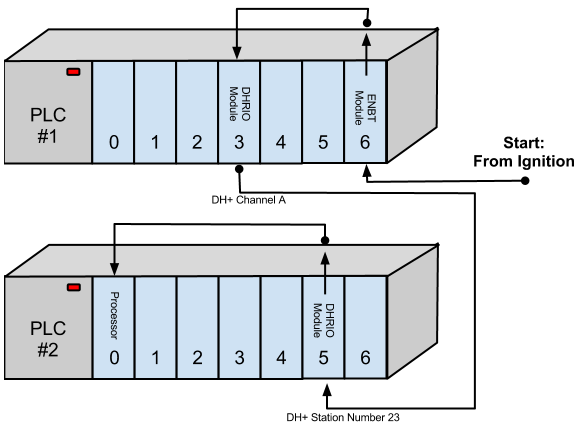

Connecting to a ControlLogix Using Data Highway Plus (DH+)​
The example below connects to a ControlLogix using Data Highway Plus that has a connection path of 1,3,2,23,1,0 going from PLC 1 to PLC 2. The device driver is the Allen-Bradley ControlLogix, and the hostname is the IP address of the ControlLogix Gateway (PLC #1).
| 3 | Move to DHRIO Module in Slot 3 |
| 2 | Move out DH+ Channel A |
| 23 | Move in DH+ Station Number 23 |
| 1 | Move out of DHRIO Module to the backplane |

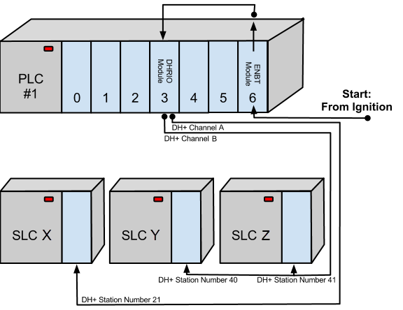

Connecting to Multiple SLCs Using Data Highway Plus (DH+)​
The example below connects to 3 different SLC using Data Highway Plus. Each SLC connection would have their own device connection, each with a unique connection path.
The connection paths are:
- SLC X 1,3,2,21
- SLC Y 1,3,3,40
- SLC Z 1,3,3,41
SLC X
| 2 | ove out DH+ Channel A |
| 21 | Move in DH+ Station Number 23 |
SLC Y
| 3 | Move out DH+ Channel B |
| 40 | Move in DH+ Station Number 40 |
SLC Z
| 41 | Move in DH+ Station Number 41 |
