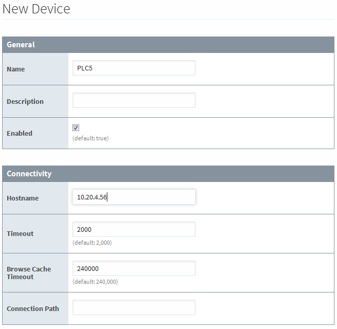

Connect to a Device​
  1. Go to the Configure section of the Gateway webpage.
  2. Scroll down and select OPC-UA Server > Devices.
  3. On the Devices page, find the blue arrow and click on Create new Device.
  4. On the Add Device Step 1: Choose Type page, select Allen-Bradley PLC-5, and click Next.
  5. On the New Device page, leave all the default values and type in the following fields:
    • Name: PLC-5
    • Hostname: type the IP address for the PLC
  6. Click Create New Device. The Devices page is displayed showing the PLC-5 device is added to Ignition. The Status will show as Disconnected and then Connected.
  7. To see all the tags, navigate to the Configure section of the gateway, and click on Quick Client under OPC Connections. On the OPC Quick Client page, expand the folder matching the name used in step 5, and expand the Global folder to see available tags.
