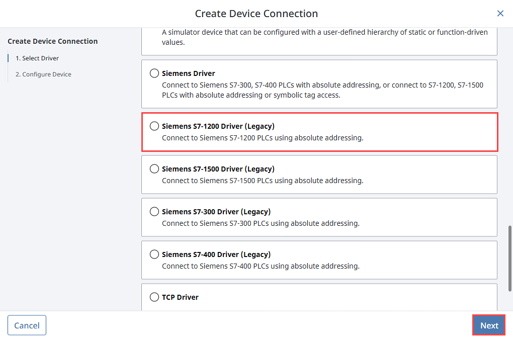

  3. On the Devices page, click on Create Device Connection +.
  4. All four of the available driver options are shown on the Select Driver form. For this example we will select Siemens S7-1200 Driver (Legacy).
    • Siemens S7-1500 Driver (Legacy): Connects to Siemens S7-1500 PLCs over Ethernet.
    • Siemens S7-1200 Driver (Legacy): Connects to Siemens S7-1200 PLCs over Ethernet.
    • Siemens S7-300 Driver (Legacy): Connects to Siemens S7-300 PLCs over Ethernet.
    • Siemens S7-400 Driver (Legacy): Connects to siemens S7-400 PLCs over Ethernet.
  5. Click Next.
