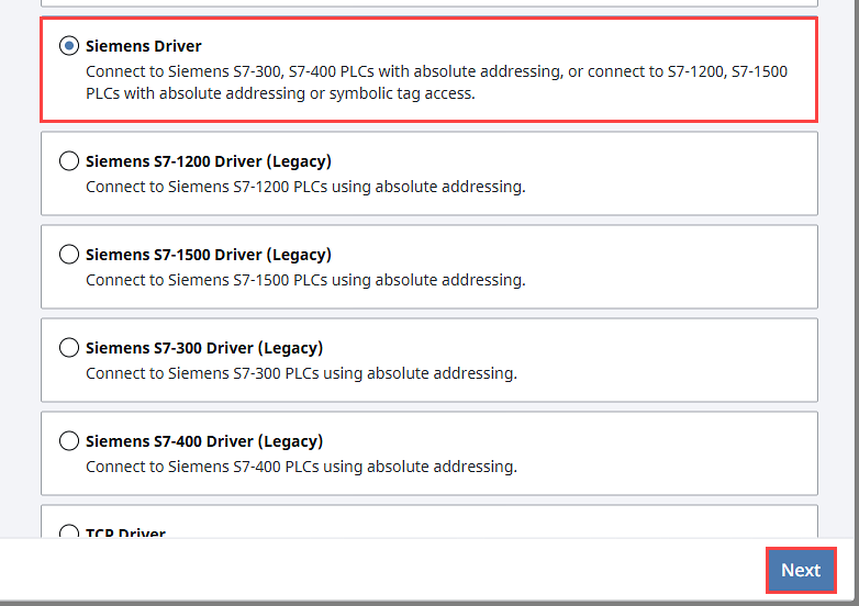

Connecting to a Siemens Device​
The Siemens Driver module requires the OPC UA module to be installed and enabled. If the OPC UA module is not installed or is disabled, this module will fault with a warning in the logs and display the state as "Faulted Missing Dependency" on the Platform > System > Modules page.
Go to the Connections section of the Gateway Webpage.
Select Devices > Connections.
On the Devices page, click on Create Device Connection +.
On the Select Driver form, select Siemens Driver and click Next.
On the Configure Device form, leave all the default values and type in the following fields:
- Name: S7_Symbolic
- Hostname: Enter the IP address, for example 10.20.4.71.
Under Device Settings, select your Device Type.
- S7-1500
- S7-1200
- S7-300
- S7-400
Select Symbolic or Absolute for the Address Type.
S7-300 and S7-400 AddressingIf your Device Type is either a S7-300 or S7-400, you must select Absolute as your Address Type to establish a connection.
Click Create Device Connection.
The Devices page is displayed showing the Siemens device is successfully created and added to Ignition. The Status will show as Disconnected and then Connected.

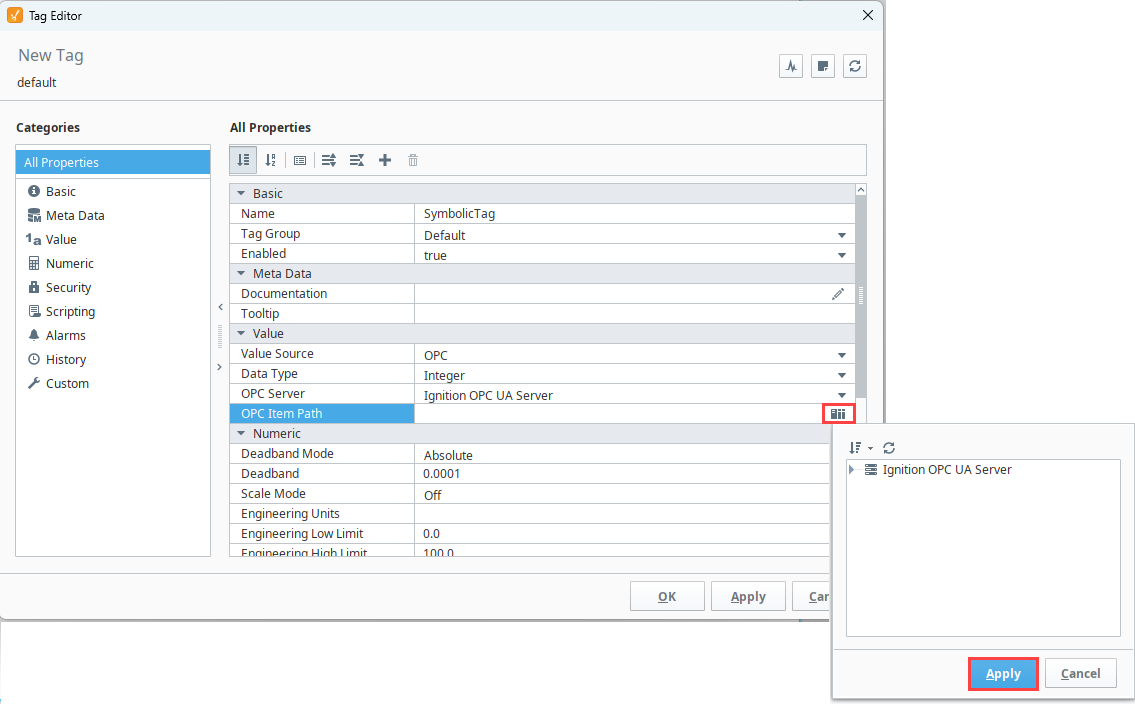

Symbolic Addressing​
The Symbolic address type for S7-1200 and S7-1500 makes tag browsing possible in the Designer.
From the Designer, in the Tag Browser, click the Add
icon.
Select New Standard Tag, then OPC Tag.
In the Tag Editor window, you will need to enter a Name, select a Data Type, and select the Ignition OPC-UA Server as your OPC Server.
For the OPC Item Path field, select the Devices
icon to browse the OPC UA Server. Use the dropdowns to navigate to your desired tag path and click Apply. The OPC Item Path will now be filled.
Click OK. Now you can see your tag in the Tag Browser.
