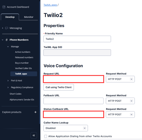

When defining your Twilio account in Ignition, you'll already have noted your Account SID and Auth Token, but more settings are required for voice notification to function successfully. Alongside the SID and token, you'll also want to confirm the number listed in the My Twilio phone number field, as this is the from number where Twilio calls will originate once our notifications are set up in Ignition. Finally, make sure your Twilio Markup Language or TwiML app includes accurate Voice Configuration properties, like the Request URL and Status Callback URL webhooks so the Twilio service knows how to handle incoming calls and messages.
These URLs need to end with /data/twilio/voice/message. Navigate to your Twilio account Phone Numbers > Manage > TwiML apps page to update or add these properties.
Once all the required configuration is complete on the Twilio side, you can get started with creating a Twilio Voice Notification Profile.
