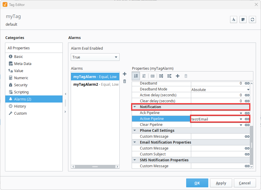

Associate a Pipeline with the Alarm​

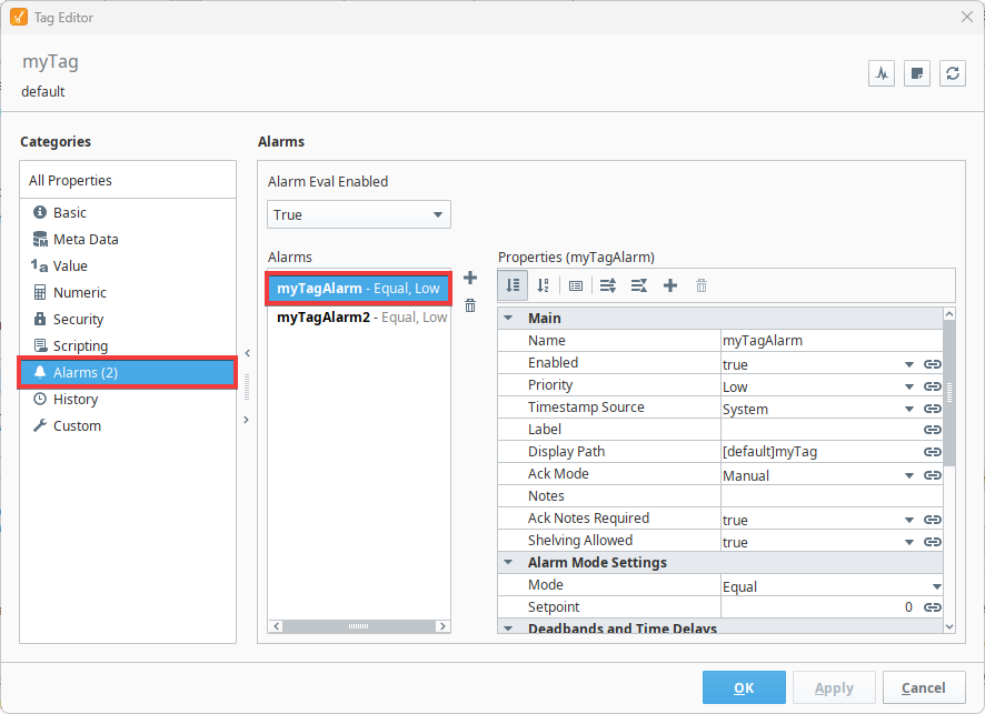

  1. Double-click on a tag that already has an alarm configured. The Tag Editor is displayed and you can access its properties.
  2. Click on the Alarms category and select the alarm you want to edit. Create one if you don't have an alarm configured already.
  3. Scroll down to the Notification section, then select the desired alarm pipeline from the dropdown for any of the alarm status states (Ack, Active, Clear). Typically, operators want to know when an alarm goes active. This example uses the Email Pipeline when the alarm status becomes Active.
  4. Click OK.
Now, every time the tag's alarm goes Active, it will use the logic in the Basic Email pipeline to notify the operators.
