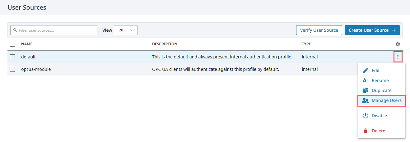

  1. Go to the Platform section of the Gateway Webpage.
  2. Select Security > User Sources.
  3. Expand the three dots menu for the appropriate user source and select Manage Users from the appropriate user source.

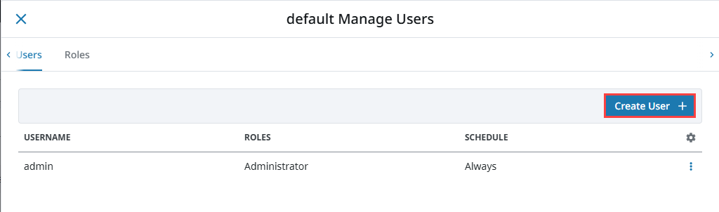

  4. Click Create User + to add a user.

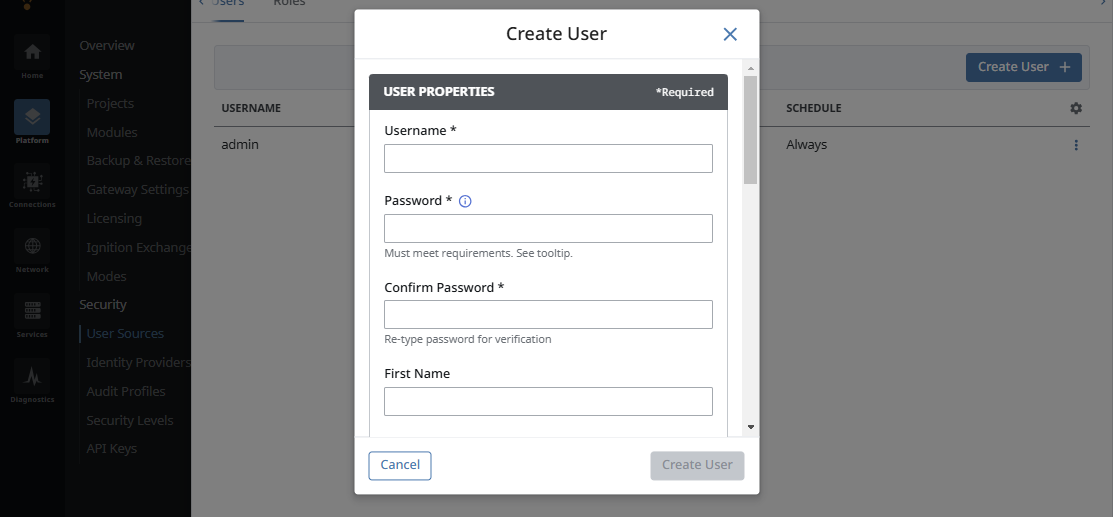

  5. Complete the fields that correspond to the user's information in the Create User form.

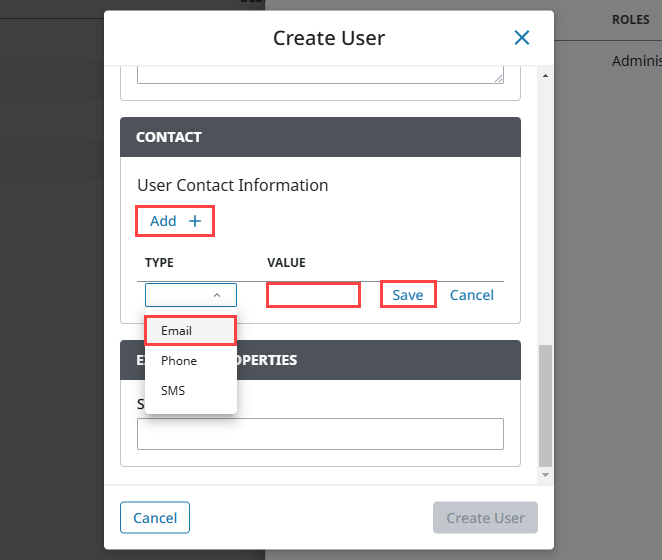

  6. In the Contact section, click Add +.
  7. Choose the delivery method from the Type dropdown list and then enter the appropriate Value, such as an email address if email was selected. Make sure to Save when done.

User Properties​
SettingDescription
UsernameUser name
PasswordPassword for this user.
PasswordRe-type the password for verification
First NameFirst name of the user (Optional).
Last NameLast name of the user (Optional).
RolesSelect the roles this user will be assigned.
ScheduleSelect the schedule for the user. Default is Always.
LanguageSelect the language for the user. Default is English.
NotesAny notes about the user.Β (Optional).
BadgeBadge ID information (Optional).
Contact Info​
SettingDescription
TypeDropdown list of contact information types, such as Email.
ValueContact information (i.e., email address).
