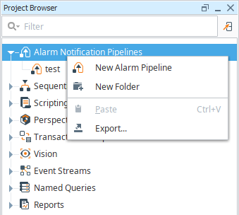

Before you create a pipeline in the Designer, you need to configure at least one alarm notification profile and at least one roster in the Gateway. Each user in the roster must have valid contact information, such as an email address or phone number, and that information must match the address used to deliver notifications in order for acknowledgements to be processed successfully. Then in the Designer, you create the Pipelines under the Global node of the Project Browser.
Alarm Pipelines, unlike other types of resources such as windows and Transaction Groups, are global resources, and are not part of a project. A defined pipeline runs in the Gateway, and you can see the same pipelines available to edit regardless of the project that is currently open. If you already have a remote Gateway configured to support alarm notifications, you can expand the already significant power of alarm pipelines by also exposing alarm pipelines that are configured on the Remote Ignition Gateway system.
Project Browser Alarm Pipelines

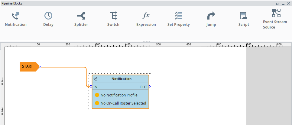

When you create a new pipeline, or select one to edit, the Designer Switches to the Pipeline Workspace. The workspace is a blank canvas on which you arrange and connect together various Pipeline Blocks. Each pipeline block has an input, and potentially has outputs. Using the mouse, you can draw connectors between the output of one block into the input of another. The START block, which you will see when you first create the pipeline, cannot be deleted and is the only fixed part of the workspace. It represents the entry point for alarm events into the pipeline, and is treated like an output block.
Alarm Pipeline Workspace

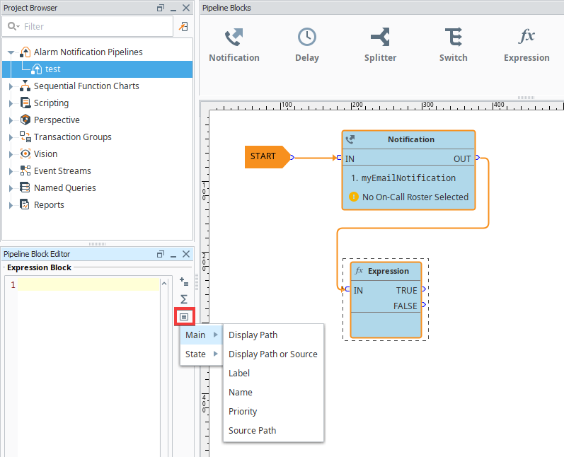

When an Expression Block is selected, you can access two commonly used sets of properties by clicking the Alarm Properties icon on the right side of the Pipeline Block Editor. These two properties are called the Main and State properties. The Alarm Properties icon is available for all blocks that have expression fields.
Expression Block Menu
