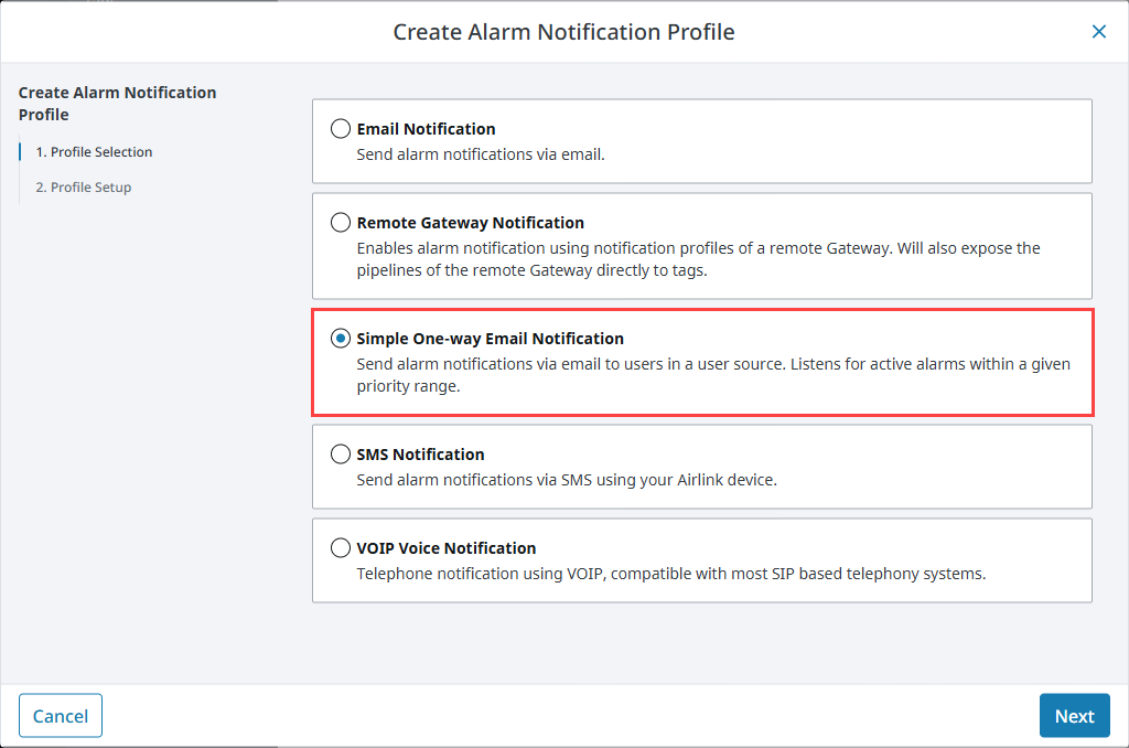

Create a Simple One-Way Email Notification Profile​
Follow these steps to create a Simple One-Way Email Notification Profile.
  1. In the Gateway, go to Services > Alarming > Notification.
  2. Click Create Profile +.
  3. Select Simple One-Way Email Notification, then click Next.
    Select Simple One-Way Email Notification from profile options
    tip
    If the profile type doesn’t appear, verify that the Alarm Notification module is installed and running.
    Go to Platform > System > Modules to confirm.

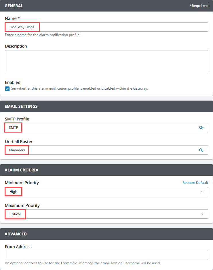

  4. Enter values for your device into the required fields. In this example, we used the following:
    • Name: One-Way Email
    • SMTP Profile: SMTP
    • On-Call Roster: Managers
    • Minimum Priority: High
    • Maximum Priority: Critical
    Configure Simple One-Way Email Notification Profile form showing example values

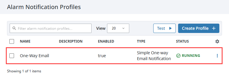

  5. Click Create Alarm Notification Profile.
  6. The profile will appear in the list and start running automatically. You can edit it at any time to update the On-Call Roster or alarm priority range.
    Simple One-Way Email Notification Profile listed with a Running status
