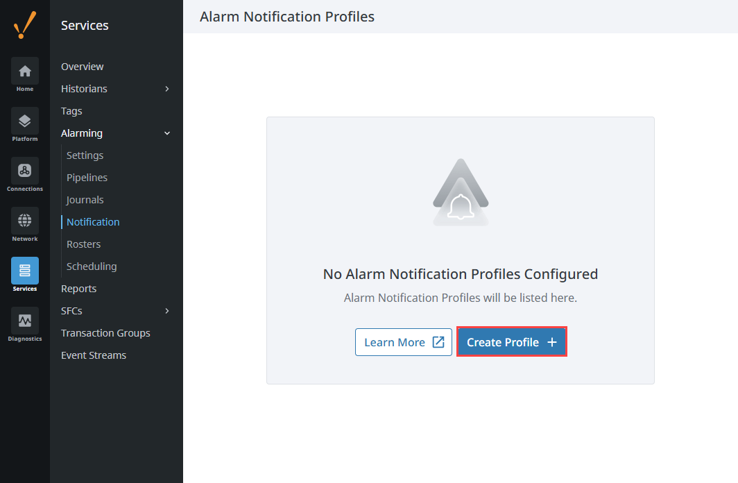

  1. In the Gateway, go to Services > Alarming > Notification.
  2. Click Create Profile +.

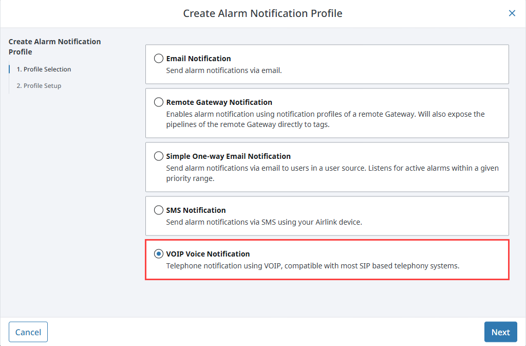

  3. Select VOIP Voice Notification, then click Next.
    Select VOIP Notification option

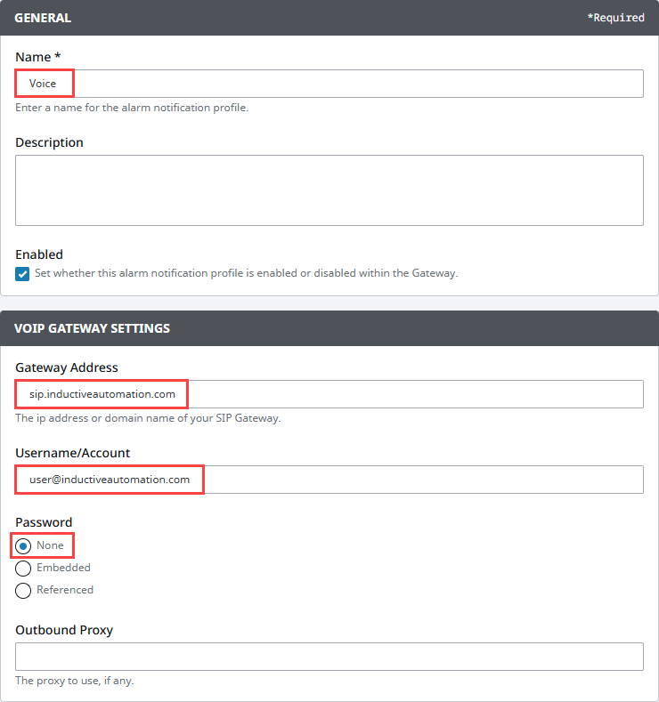

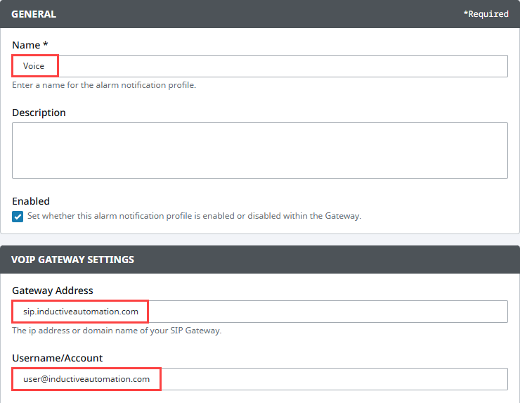

  4. Enter the following required values as an example:
    Configure VOIP profile setup

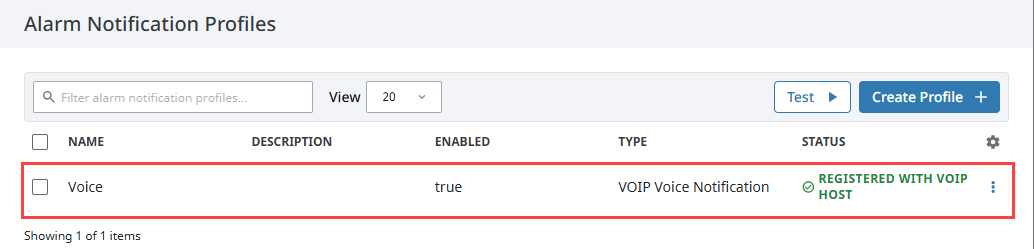

  5. Click Create Alarm Notification Profile.
  6. The profile appears in the list and will display Registered with VOIP Host once configured correctly.
    VOIP profile with Registered status
