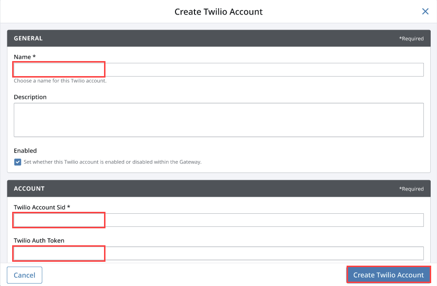

Define a Twilio Account​
Before a profile can be created, a Twilio account with the necessary capabilities must be created (www.twilio.com) and then defined in Ignition.
Navigate to the Services section of the Gateway Webpage.
Choose Alarming > Twilio.
On the Twilio page, click Create Account +.
Provide a Name for the account as well as the Twilio Account Sid, and Twilio Auth Token. Both the Account SID and Auth Token can be retrieved from the Account Settings menu in Twilio.
If desired, you can add an IP address of a local network to the Local Address, which will then be used instead of the default network interface.
If desired, provide the Public Hostname. This is the hostname or IP address that inbound requests will be forwarded. If the users should be able to acknowledge alarms by responding to the SMS messages, then this property should list a publicly reachable hostname or IP address.
Click Create Twilio Account.
