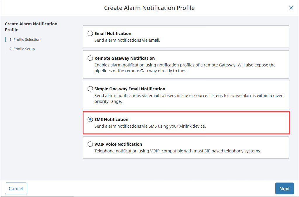

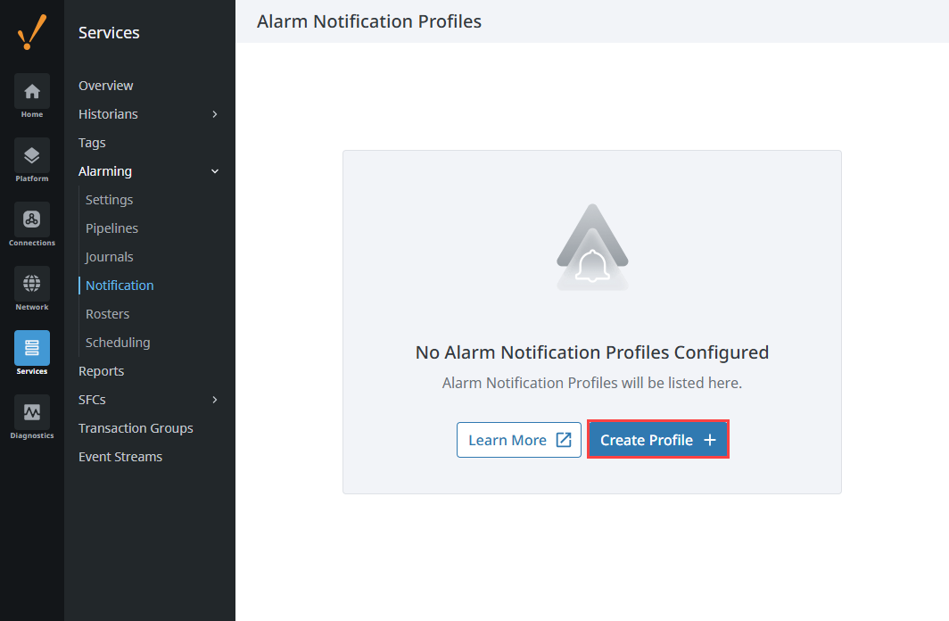

Create an SMS Notification Profile​
Follow these steps to create an SMS Notification Profile.
  1. In the Gateway, go to Services > Alarming > Notification.
  2. Click Create Profile +.
  3. Select SMS Notification, then click Next.
    Select SMS Notification from profile options
    tip
    If the profile type is missing, go to Platform > System > Modules to verify that the Alarm Notification module is installed and running.

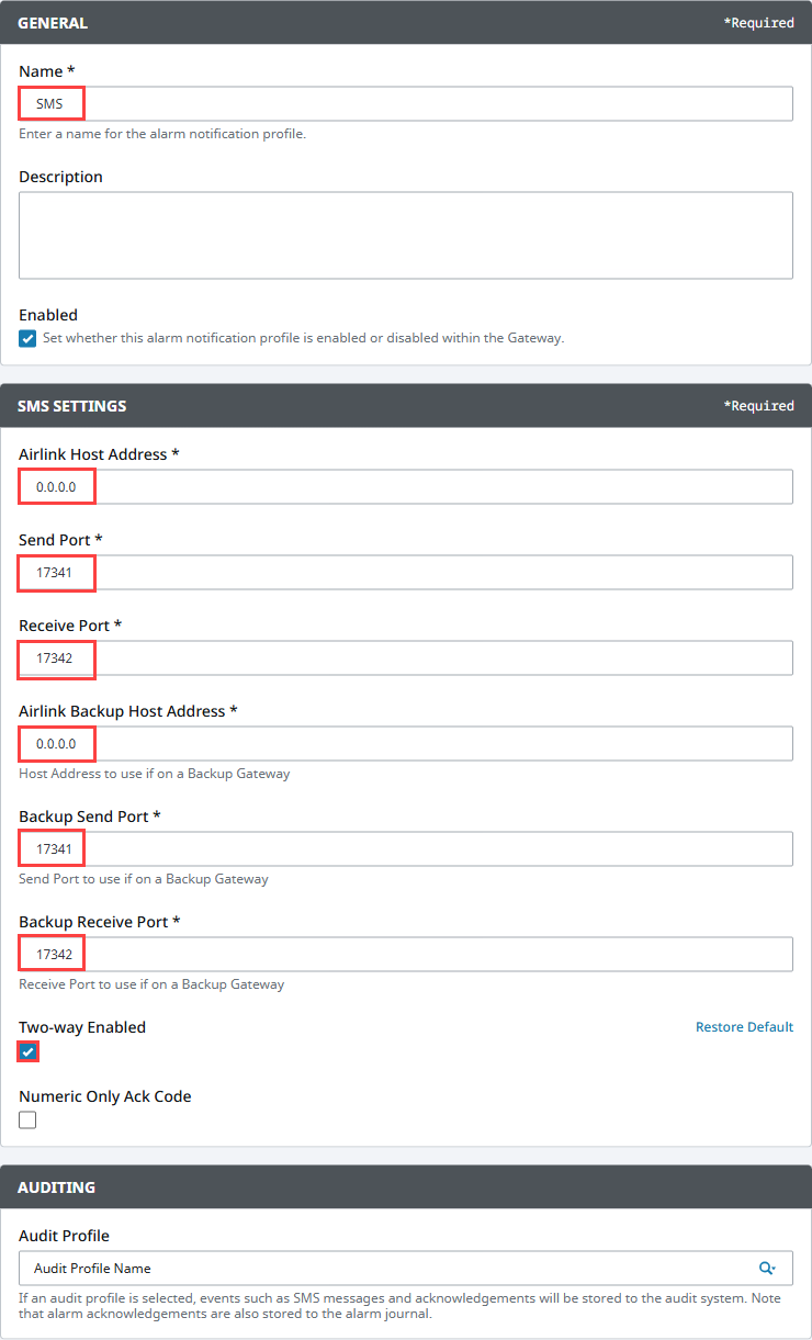

  4. Enter values for your device into the required fields. In this example, we used the following:
    • Name: SMS
    • Airlink Host Address: The IP address of the Airlink modem.
    • Send Port: 17341
    • Receive Port: 17342
    • Airlink Backup Host Address: The IP address of the backup Airlink modem.
    • Backup Send Port: 17341
    • Backup Receive Port: 17342
    • Two-way Enabled: True
    Configure SMS Notification Profile

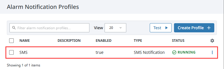

  5. Click Create Alarm Notification Profile.
  6. The profile appears in the list and will begin running immediately. You can edit it at any time to modify the modem address, backup ports, or acknowledgment behavior.
    SMS Notification Profile listed with Running status
Once configured, you can assign phone numbers to users using the SMS contact type.
SMS Notification Profile Settings​
Main​
Property NameDescription
NameName of the notification profile.
DescriptionOptional description for the profile.
EnabledWhether the profile is currently active.
SMS Settings​
Airlink Host AddressIP address of the primary AirLink modem.
Send PortUDP port used to send messages to the modem. Default: 17341.
Receive PortUDP port used to receive alarm acknowledgments from the modem. Default: 17342.
Airlink Backup Host AddressIP address of the backup modem used by a redundant Gateway if redundancy is configured.
Backup Send PortSend port to use when in backup mode.
Backup Receive PortReceive port to use when in backup mode.
Two-way EnabledAllows recipients to acknowledge alarms by replying to the SMS.
Numeric Only Ack CodeForces acknowledgment codes to be numeric only (instead of alphanumeric).
Auditing​
Audit ProfileStores SMS message events and acknowledgments in the selected audit profile. Alarm acknowledgments are also written to the Alarm Journal.
