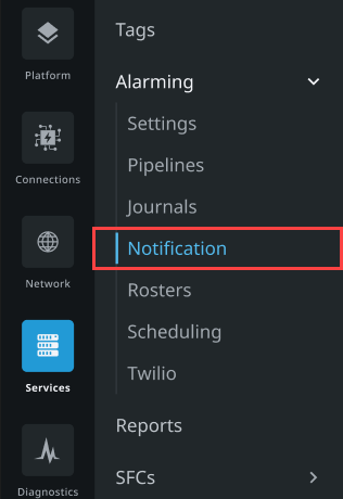

  1. Go to the Services section of the Gateway Webpage.
  2. Select Alarming > Notification from the menu on the left side.

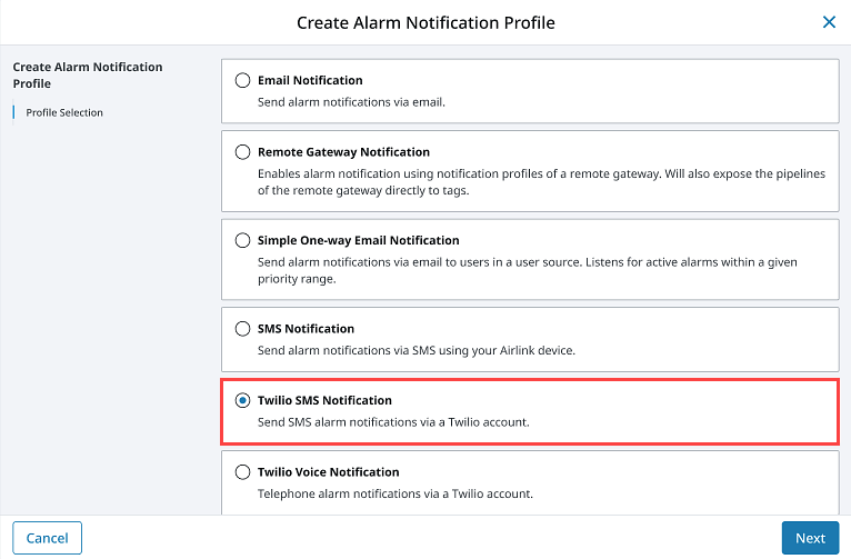

  3. Click on Create Profile +.
  4. Select the Twilio SMS Notification profile type, and click Next.
  5. Provide a name for the profile, and select a Twilio Account from the dropdown.
  6. Set the other profile settings as desired. (See table below for a description of all settings.)
  7. Click Create Alarm Notification Profile.
