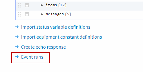

Each simulator can have multiple event runs specified, each with a unique set of events. To access a simulators event runs, go to the Gateway Webpage Configure section and navigate to the SECS/GEM > Simulator page, and in the More menu to the right of the simulator select the sim variables option. At the bottom of the SDL editor tool, there will be a link for Event Runs that will take you to the page where new event runs can be created.
