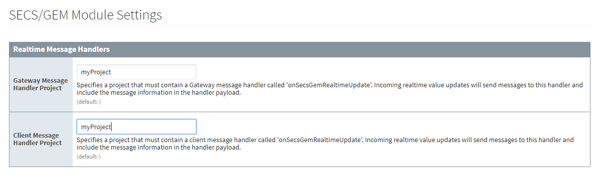

Once an onSecsGemRealtimeUpdate Message Handler has been specified, it needs to be specified within the Gateway. Within the Gateway Webpage Configure section, the Module Settings page under the SECS/GEM header will have Properties to specify which project holds the Gateway Message Handler and which project holds the Client Message Handler. These can be the same project or different projects.
An Example with S2F14 using the Simulator​
This example sets up the S2F14 message to call the Gateway Message Handler that we setup. It assumes the equipment connection is made to a simulator with the default SDL file. In order to capture message with the onSecsGemRealtimeUpdate, the SDL File will need to be configured to allow that. Here we setup the SDL File to have S2F14 to go through the message handler.
  1. Create a Gateway Message Handler called onSecsGemRealtimeUpdate.
  2. Go to the Gateway Webpage Configure section, and navigate to the SECS/GEM > Module Settings page.
    1. Specify the project that the Gateway Message Handler was created on in the Gateway Message Handler Project setting.
  3. Within the Gateway Webpage Configure section, navigate to SECS/GEM > Equipment.
    1. On the equipment connection, edit the SDL File.
  4. Locate the S2F14 message in the list.
    1. Add "realtime" as an Auto type object with a value of "true" directly under the S2F14 root.
    2. Create an array called "CommonID" directly under the S2F14 root.
      1. Add "0: ECV" to the CommonID array as an Auto type object.
  5. Save the SDL file and restart the equipment connection.
