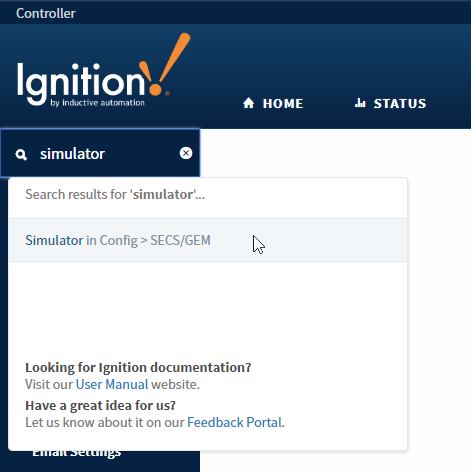

    • From the Configure section of the Gateway webpage, scroll down the list of links on the left until you see the SECS/GEM section. click on the Simulator link.
    • Alternatively, use the search bar located in the upper left corner of any page on the Gateway, and search for simulator.
